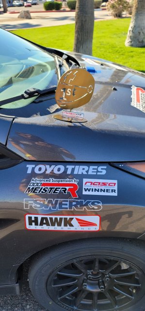

Just finished the second TT weekend with a win each day in TT5!
We were at Radford (used to be called Bondurant) with NASA AZ. Since the previous weekend we added the Fastbrakes.com Front Brake kit, went to -2mm total toe out in rear, and switched rear from 225/45/15 tire size to 205/50, with 245/40/15 Fronts. Saturday we were able to get to a 1:12.2 with 225/45F tires and 205/50 R, but we went with the 245/40 on Sunday morning and laid down a 1:11.2 in the first session. The fast laps on Saturday were later in the day, so I dont really expect that there is a 1 second difference in the 2 tires, but there is definitely a decent chunk of time going to the 245s. Still running the 15x8 TD Race 1.2 wheels, but plan to switch to a 4x100 15x9 front within the next month or 2. hopefully we can get them to fit under the fenders...
Didnt remember to hit record on the camera for the 1:11.2 lap, but got a session with a 1:11.7
