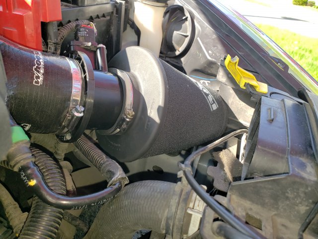

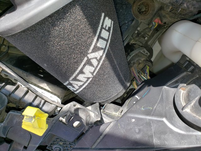

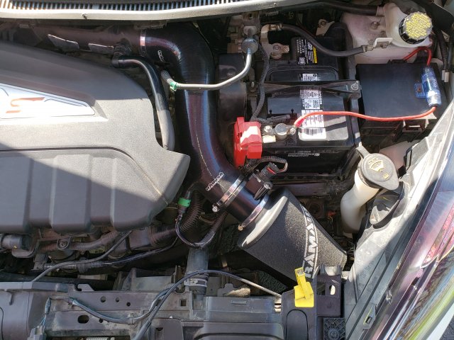

Installed a Whoosh V2 short ram with a Ramair foam filter. Unfortunately, the filter hits this bracket between the headlight and radiator.
Has anyone else had this happen?
Does it matter?
Does it matter?
https://www.dremel.com/us/en ;)
seriously though, if you loosen up the screw holding the filter onto the MAF adapter you can tweak the filter around. I've found most FiST intakes with cone filters need a bit of that. I have the other ramair intake that points downward and I had to finagle the filter around to make it work correctly without rubbing. Remember the engine rocks around, if its rubbing now, it will possibly wear a hole later. Maybe send the pics to ron for clarification if nobody replies. Or, check youtube there are probably videos of people doing the install

I did try adjusting the filter around but I will give it another shot. Thanks for the tip, I didn't think about the rubbing becoming a hole. :eek:

It’ll move a lot as it’s not supported by any bracket. I’d try loosening the induction hose clamps on both ends and try to point the filter downwards some. Break out the trusty razor and trim the silicone if needed to create an angled face.
