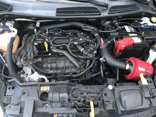

I have a 2016 st. I purchased a used 2014-2015 injen intake. (I didn’t realize they changed after 2016) Anyways I saw some old post about adapter kits for 2016 and up models but I don’t know if those are still around. What are you guys currently using to fit older cai on 2016 and up models?
Order a 2014-2015 evap harness and it’ll work. Whoosh has them or you can get it from rock auto, Ford, wherever.

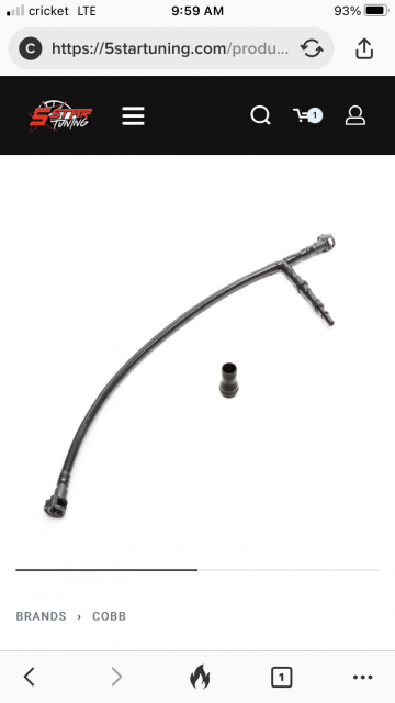

Dang I just checked and those are $160!
I found this Cobb adapter kit for $40. It’s made for their intakes but I figured I could make it work with mine. Any thoughts?
I’ve never used one of those adapters so take this for what it’s worth - I’ve heaed those work great for some and others still get the check engine light. The full harness works perfect all the time as it’s an OEM solution.

Ok thanks for the info. I decided to try the Cobb kit. I’ll update this page on how it works

As far as the injen intake goes. Fitment was great. The sound is amazing! I have noticed my intake air temps have gone up when stopped. When moving it’s pretty close to stock temps. It does have a heat shield to help things alittle. I’m gonna add a big mouth snorkel to get some more cool air in there and a mountune intercooler. Well see how much that helps.

Update. I get a code once every other week or so. I put the big mouth snorkel on. It helped the intake temps alittle but still sucking hot air. I heard of somebody fitting the stock air box over the Injen intake. Anybody done any mods to help the injen with the intake temps?
