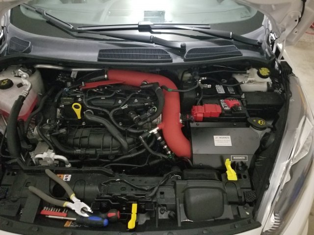

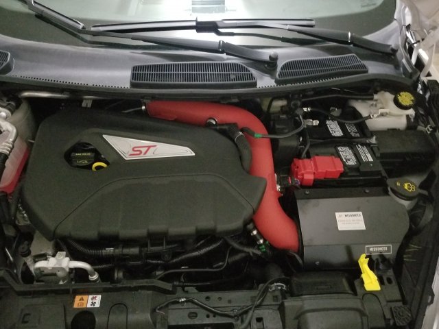

It's the first mod I've ever made to a car (first car I've had worth modding) and I wanted to drive it everywhere yesterday. I love the wrinkle red too because it matches the ST badging.

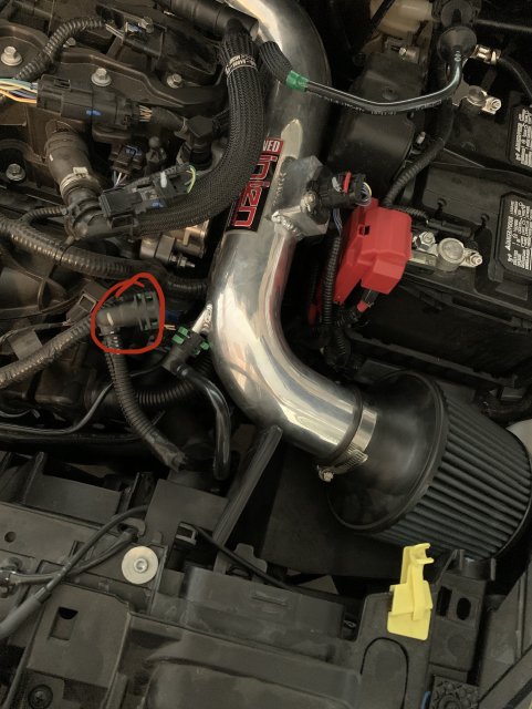

Just installed an injen cold air intake on a 2019 fiesta st and have absolutely no clue where this goes
Sinse Injen does not make a cold intake for the 2019 FiST yet.
Your guess is as good as mine and I don't know.

It looks like the injen intake is for the older model Fiesta evap systems. Starting with the 2016 we got a dual port evap harness as opposed to the single port of the 2015 and back models.
There are some ways around it as I know whoosh motorsports as well as Cobb sell a conversion kit/check engine light fix(you will get a CEL unless both are connected).
You can also buy the entire harness from ford/tasca/whoosh if you don't want to chop up your current harness for emission reasons.

Would you say it’s safe to drive for around 3-5 days until the part comes in?
Spork1569
689
533
Fillmore, CA
Idk if it'll damage anything in the long run. It will for sure throw a code when the entire harness isn't plugged in(did this on accident when installing my silicone induction hose).
You could always go back to stock for a few days while the parts come in of you want to be on the safe side.
