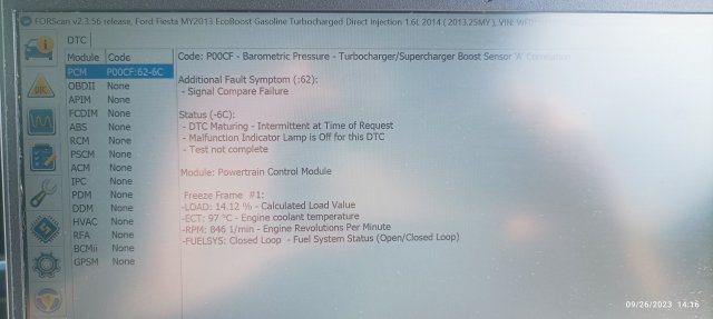

Replaced the in-tank fuel pump yesterday and today I clear codes and rescan and get the code: P00CF.

#36
Today I removed the low pressure fuel sensor to check the O-ring and it seems ok to me, I removed the O-ring and put a few wraps of thread tape on the thread then put the O-ring back on and the first two startups i could'nt smell any fuel but time will tell, I will bring it up to operating temps tomorow and see if the code comes back.
