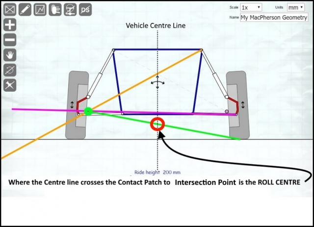

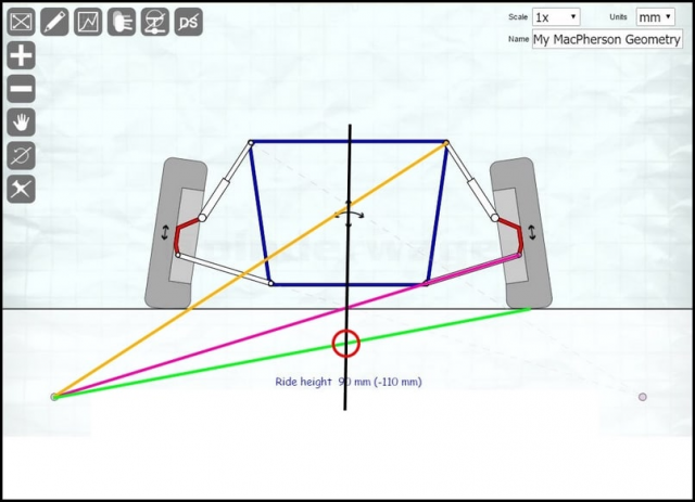

Here's why lowering too much AND without a proper adjustment in spring rate will cause more roll over. The distance between the center of gravity and the rolling center in a car (overly simplified: point where the car body rotates about) can increase a lot when the car is lowered too much. This means there is a larger moment arm on the car's rolling center (think longer wrench, more leverage). This causes more body roll. Normally it's combatted with higher stiffer springs. However when paired with progressive rate springs there is even less resistance to rolling, even more so when changing directions as the spring that is rebounding has a higher rate than the spring that is being loaded.
See images of a more extreme example (lowered by 4.3") below
1609853689984.png .
Suspension geometry stuff is still pretty new to me so if anyone else has more insight on this, that'd be great

205/45-16 is shorter setup than stock, and I was planning on running 215/45 next season (still slightly shorter than stock) What tire were you running that you felt sidewall flex?
Also, I'm sure there is a point where lowering goes from positive to negative impact on handling, which might explain why you feel that the setup as been working great for you. I'm lowered on Swift springs and the car feels 10x more stable than it did with the stock setup, so we both may be just be at at a good height.
But where that crossover point is? I'm not sure, that's were I was hoping someone with more experience might be able to answer. I'm going to go find a book on this stuff. Got plenty of time to kill while cooped up at home
