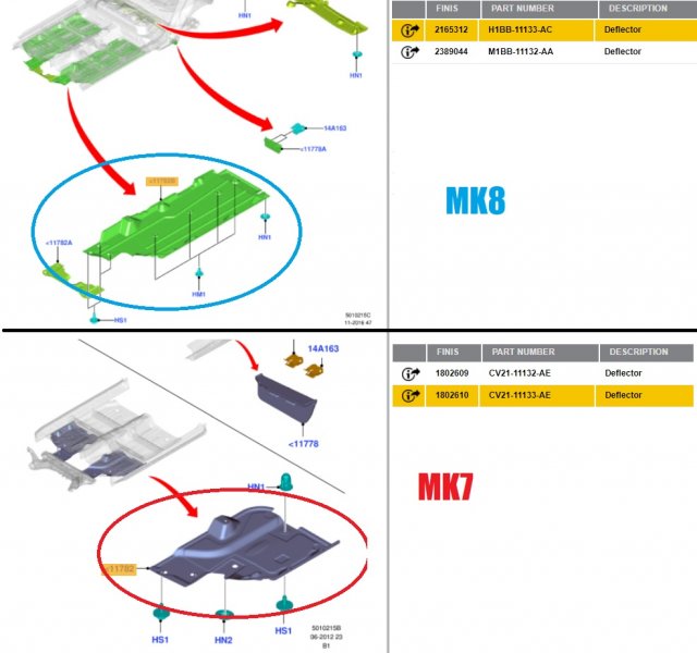

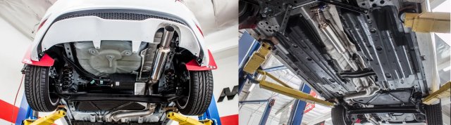

I am posting a photo I found (here I believe) of a fiesta ST mk7.5 us spec that has underbody panels
After searching in a few parts sites that have all the data and parts available for your specific VIN I found out that these panels are not available (or not installed) on the EU ST mk7.5 but are installed in the 2020 onwards Fiesta ST
picture here:
Since I want to install them to my fiesta, is there someone who can confirm that his mk7.5 st actually comes with these panels as standard and if so, what are the part numbers of them?
Thank you everyone
picture here:
Thank you everyone
