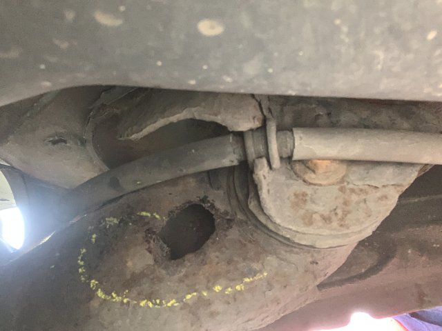

Fiesta mk6 1.4 tdci rear suspension arm

There's a lot of preparation work that would have to go into the repair site, which is really close to a bushing. My guess is that anyone serious about a real repair is going to want to yank the arm. At that point it's cheaper to replace with a new one or a junkyard take-off.
