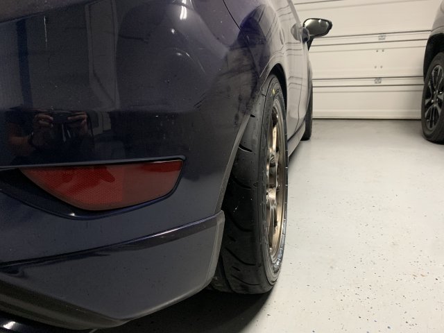

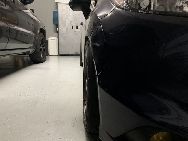

You should be ok. I raised the front a little bit after taking these pictures and I don’t rub anymore. I’m somewhat low too. Haven’t had a chance to run it at autocross just yet but I haven’t rubbed since raising the car, even on pretty big dips. These are 215/45/16 on a 16x8 Dekagram

ya I probably would not rub if I put 215/45 RT660’s on my Dekas as I did not rub with my Feddys. The 215/40/17 is a taller tire which is why I ran into some rubbing.
The RT660’s are THICK compared to the RS Pro’s. They’re bigger in every dimension and it really shows once they’re on the car. Should try them with your S280, I’m hooking second on a FBO E30 car. I would roast second on RS-Pro’s unless they were hot lol
Whew, that's close. I have Enkei RPF-1 16x7s. Looks good!
Only rubbing I had was on the plastic fender liner. I surprisingly wasn’t hitting the nub for the bumper bolts which is what I originally thought would be the case. I wonder how ballooned it’ll look on 16x7’s. IMO they look perfect on 16x8.
