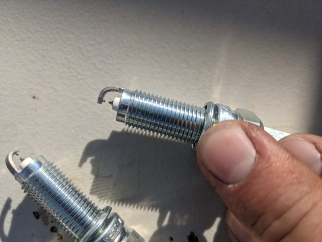

This really cheesed me off. When my wife's Honda hit 100k two years ago, I swapped the spark plugs with "OEM Honda replacements" purchased on Amazon. They were the right NGK part number, and had the right Honda part number printed on authentic looking Honda boxes. All seemed great. Gapped, installed, and off we went. A few days ago, the car started stumbling. I didn't think plugs could be an issue, since the new ones were OEM and only have about 20k on them. But, I couldn't find anything else wrong, and doing some research on the web, I started reading about people receiving counterfeit Honda spark plugs from Ebay and Amazon dealers.
Sure enough, I pulled the plugs, and the pointed electrodes are melted down to a stub on all four, opening up the gap to over twice the spec. Thankfully, it doesn't look like any part of them broke off, but probably just vaporized.
Looking back, the price was good, but not "too good to be true". Just ordered a new set from Rock Auto, can't wait to get these fakes out.

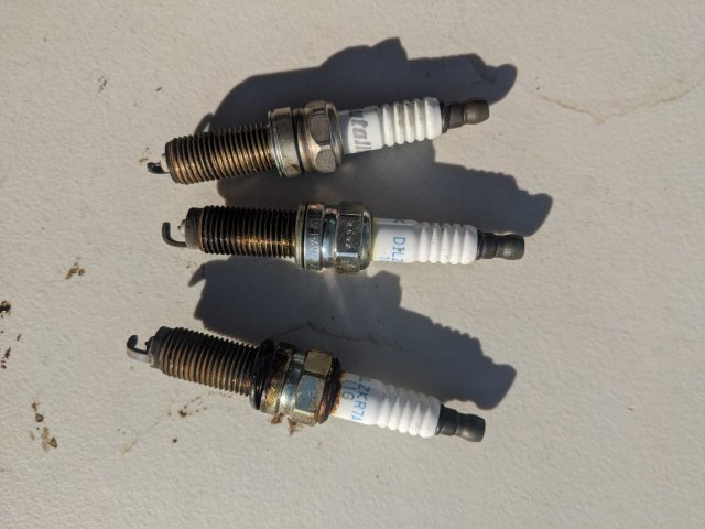

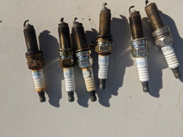

My buddy just realized this on his Honda. He bought the plugs on Amazon and 10k miles later had horrible misfires. Because his plugs were new he checked them last and they were awful. I have pics to show. You’ll notice that the auto lite was accidentally left in and had 70k miles on it.

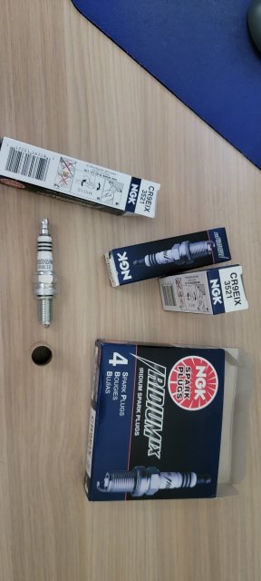

Here's what I got. Everything looks legit to me. Price was the same as I found anywhere else but shipping was faster.
Here they're listed on the NGK site: https://www.ngk.com/ngk-3521-cr9eix-iridium-ix-spark-plug at about $8 a pop. The Amazon price was spot on.
Took a pic of the unused new plug (bike is a triple) and it's labeled correctly and looks fine. The print on the plug is the same as the print on the picture from the NGK site too.
So, I feel like these are legit. Packaging, labeling, printing, all of it looks legit. Plugs are in the bike now and the bike starts and rides perfectly. Better actually, than with the older plugs that were installed before.
These were purchased through a seller on Amazon, not through Amazon directly, but they're highly rated and the reviews for the plugs are also normal.
Not sure how to feel. I don't have any way to really know but I guess I'll just have to pull and check the plugs in a few thousand miles to make sure they're still looking good.

If you have a spare one of those plugs out (since its a triple and you bought 4 lol) try to wipe the writing off of it with alcohol, if it wipes off they're probably fake.

Thanks for the tip with the alcohol. I gave it a shot and nothing happened. That gives me a little more confidence.
