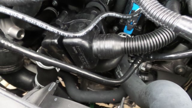

Went to get my car smogged today and had no issues with the sniffer. However, the referee had an issue with the symposer delete. Does anyone know what the oem part number for the diaphragm as well as the connector hose is?

C1BZ-9P437-A
1.6L turbo.
The hose comes with the Symposer/Resonator

Regardless, the law in California is that you cannot modify anything between the mass airflow sensor and the cat.
Unless there is an EO to allow it.
So as stated above, just put it back on before a smog check.

My understanding and personal anecdotal experience is that you cannot modify any engine component unless the replacement part includes an EO number specific for your vehicle. This includes components forward of the mass airflow sensor such as air filter, air box etc.
Here they are talking about the air cleaner/air box assy. not the air filter.
On the FiST, the MAF is in the top of the air box so anything before it is fair game.
Therefore you can change the bottom of the air box or air filter without any violation.
This is why the Mountune or ST200 lower air box is legal.

I sure hope you don't have to spend good money on a symposer. Living in CA there is likely a number of members here who did not throw out their symposer when they took it out. Hopefully you can borrow one and your rubber hose is still on your car with a simple plug in it. As far as the hose to the firewall goes, it is often also left in place, pushed back and sometimes plugged.

apex1 - Luckily the rubber hose is still attached and was routed behind the battery. I'm trying to buy a used one off a forum member but if anyone near the ventura county area or near the SFV can spare one for a quick test I'd appreciate it!
