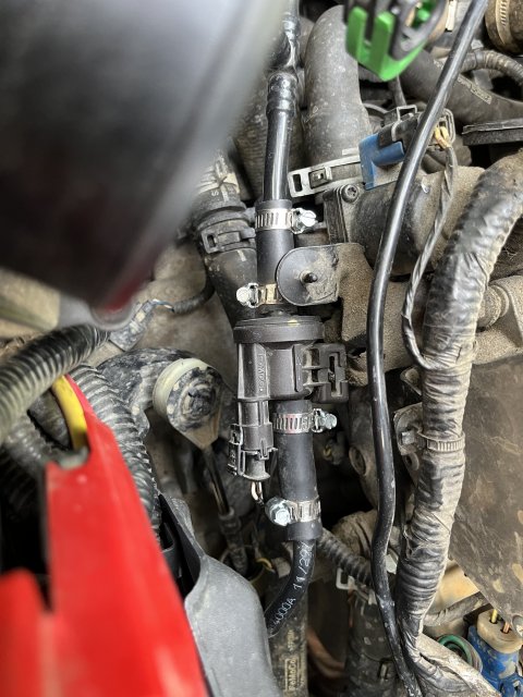

Mine is doing the stumbling idle thing after filling up and I always leave the pump in at least 30 seconds and never keep going after the click. The other thing I’ve noticed is that if I fill up from a gas can it will still have the same issue. Im going to replace my purge valve and see what happens.
I have modified the lines where the purge valve is with rubber lines and hose clamps so changing it is pretty easy

Anybody got diameter and lengths of rubber hoses needed to make this valve a cheap and easily replaceable item? I assume you reuse end fittings from the existing harness and a couple of new clamps at the valve?
