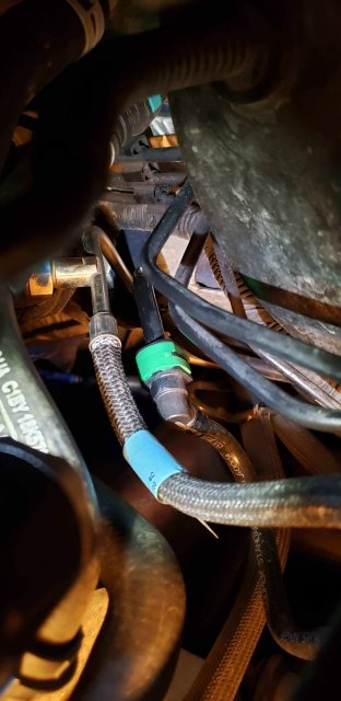

If you have a 2016 fiesta or newer you'll have a hard time with most kits. Will have to do either the tank install or something else. In image, fuel is line with blue tag. Note how its crimped on vs the quick connects of the past.
