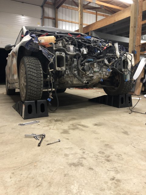

I haven't pulled the engine and trans yet, but I often pull the entire radiator / core support whenever I need to do most anything under the hood. Would make pulling the engine/trans very easy.
This might be in your plans already, but after pulling the headlights, pull the front bumper and you'll see 4 bolts holding the entire core support/bumper beam/intercooler in place.
With that out of the way, you'll have access to everything you need. (y)

There are certainly a lot of jobs that are easier with the motor out! If those Mishimoto hoses are silicone, just note that one side effect of running silicone rad hoses on a daily driver (any car really) is they do have a tendency to "sweat", and you may need to monitor coolant levels every so often, and may get a slight coolant smell in the vehicle at times.
It's been about 50/50 for me in the past on whether or not it happens with silicone hoses, and depends a lot on the particular formulation or silicone that is used and amount of condensation that develops in the coolant circuit in your region.
I just put the whoosh hoses in my car last night, so I'll let you know if they "perspire".
Mounts are a great choice. And I'd inspect the "dog bone" / "lower trans mount" / "rotation resistor"... whatever it's called, mount on the bottom of the trans. Those seem to have a tendency to wear out, and I just did mine with the whoosh mount last night after my Cobb one failed. Took less than 5 minutes to install.
If you really wanna get wild, I second the LSD comment. No easier time... but make sure to do the homework on that one, because there are lots of small auxiliary parts like one time use bolts, shims, bearing installers, etc. you will need if you go down that road. (And many aren't in stock at Ford or other retailers right now.)
69
126
Lapeer, MI, USA
If you happen to think of it, I'd really appreciate if you can post up a photo or link of what spots / mounts you lift from when you pull everything out.
I'm planning a big overhaul at the end of this season and was curious where to lift these motors/transmissions from! :unsure:

Finally got the engine and transmission (and subframe and wheels and rack and suspension and... and... lol) home from work, planning to pull the transmission off the 'new' engine tomorrow and check compression, pull the clutch and flywheel, replace the axle seals, check everything else... this is weird for me, I've never pulled a perfectly good engine before just to replace it with the same thing with a lot fewer miles. Lol... I figure I had to do the timing belt, serpentine belt, coolant, etc anyway real soon, I may as well put the 22k mile engine in instead while i'm doing the transmission.
Would you mind giving a little close up for where you grabbed onto to lift it out?
Did going out the front work well for you? Looks like you cleared the ceiling!

That's actually the 'new' one, I just finally got to borrow the work van and get it home- I don't have pics, but that one is held by the left and right mount bolts. I just fabbed some angle steel into brackets at work (just drilled a half inch hole on each side of the angle) and stuck high strength carriage bolts through the vertical hole in the bracket so it can't slide off. When I do go to pull the old one I'll check my ceiling clearance with the arm shortened and the chain as short as I can get it (the pic shows it as long as it goes so I could get it out of the van, my driveway is sloped so it was a pain getting it high enough to drive out from under it). If I can, I'll just go straight out the top, if not I'll do as you suggested and pull the front apart. :) I'll probably jack it up and hold the assembly with jack stands to get the mounts off and put on the brackets to lift it, then do the reverse putting the 'new' one in. I hate working in a single car townhouse garage, I barely have space to get the jack under the car to put it on stands, much less ceiling height and room in front. Next house is definitely going to need a better garage, but @DRVIPER711 gets to buy that one- it's her turn. :p

Also, now that it isn't diagonally on a pallet in the back of a van, I can probably find a better lift point. lol... I'll update with whatever I come up with.

Pretty sure you could find an eye bolt to fit somewhere on the other site. Wondering if the stainless steel shift cable brackets are considered load bearing cuz if so you could put a tow strap under those. Me personally, I used an eye bolt in the exhaust manifold holes and believe there was a grab location at the front of the engine as well. I also had the engine hoist adjuster (thing you can change the pitch of the engine with) so I had a lot more control on the angles and how the engines weight was distributed.
