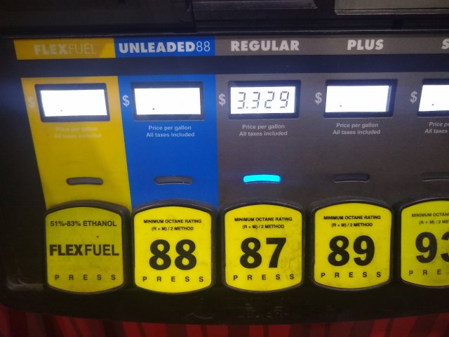

One more question, at the gas pumps, I read yellow is e85. All the yellow pumps here say flex fuel. I assume that's e85?
Example picture. The yellow is what I want?

You aren't putting in 87 are you? If so you're only cheating yourself out of the cars full potential of not running on 93 at minimum of 91. Mine only gets 93 or the mix of 93 and e85 to get e50 for my 4 port and BT. But yes... when the pump is Yellow it indicates e85 and the pump usually states the legal disclaimer of it may be anywhere between 51% and 83% of e85 by law.
No, definitely not putting in 87, I've never seen 91 here, so I use 93.
Thanks, that 51% - 83% is why I decided to ask here. Better to ask a kinda stupid question than end up with a blown up engine 😂
