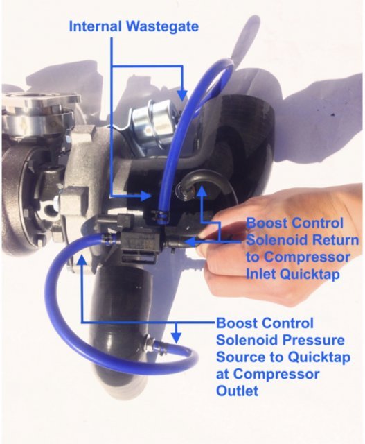

great, at least that confirms its the boost not coming I'll have a look at the solenoid routing today, one thing i did notice was that the tubing going from the internal wastegate to the boost solenoid was very loose, like it would fall off if i gave it a tug. it may not be sealed completely ive got another bit of hose im gonna swap it out with when i look at the routing but if that tube wasnt sealed between the wastegate and the solenoid could that potentially cause the issue?
1724785730324.jpeg The internal wastegate to solenoid hose in this pic.

Well problems solved, the boost solenoid was around the wrong way, flipped it and its making boost now, got about 50m down the road and popped an intercooler hose off lmao. Cleaned the pipe/intercooler pipe and it seems to be holding up well. gotta run the scan tool and make sure the numbers look right but it sure feels waaaay faster than before. @Mega ST @thecman02 thanks for your help :D
