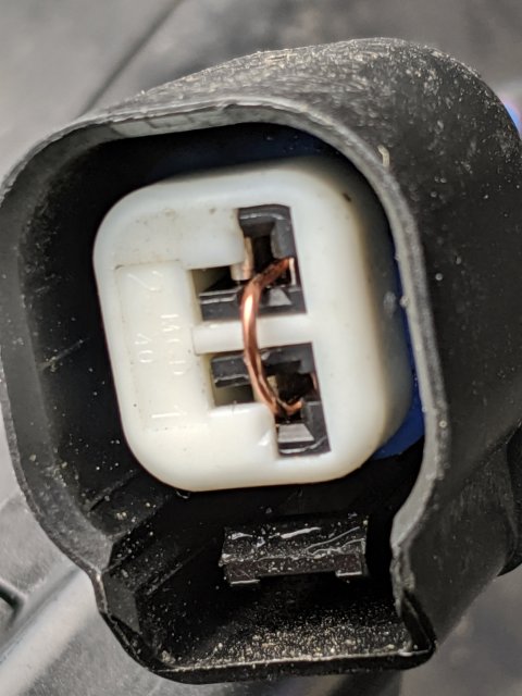

Just picked up my 2014 ST from the stealership and paid $215 to have the hood latch replaced due to door ajar light constantly on. Part number is 16700. Probably wouldn't be too hard to do it yourself and save the money. Also they kept the car overnight because the part is not kept in stock. Car alarm kept going off and waking the neighbors. I left the key in it for a couple of days to alleviate that problem because it won't lock with the key still inside. https://parts.ford.com/shop/en/us/latch-assy-hood-6458023-1

I took some 30 gauge solid copper wire (from a CAT5 cable) and formed a jumper, and stuck it in the plug Plugged it back in. Looks stock, and the latch can be replaced if desired later on down the road.
Bumping an old thread - is that the hood latch sensor? Jumping it like that made the dash light go out?
