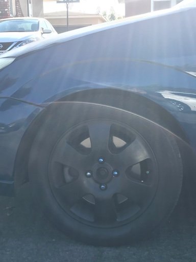

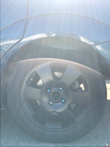

My neighbor picked up a new beater a few days ago... nothing special until I noticed the brakes today: large discs on the rear! Even the fronts look larger. It’s an earlier model Focus sedan with grey cloth interior.
Did someone swap SVT brakes on this thing? IMG_0088.JPG IMG_0090.JPG IMG_0091.JPG

The stock diameter of non svt brake rotors is 10.2 inches in the front. Cant comment on the rear, mine has drums lol.

Could be svt rears. Could be advancetrac rears.
If its 280mm its svt
If its 253mm its advancetrac.
(Had an advancetrac that i swapped up to svt stuff.

The fronts could be 05-11 focus fronts which are 280mm as well. Only way to tell is to measure the rotors.
