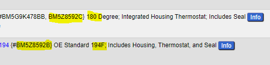

Also, if you search Tasca/equivalent dealer sites, you see both Ford part numbers cross referenced, one ending in B is a 194 and one ending in C (newer rev) is a 180...
I can also tell you that mine clearly has a 194 as my temps sit very close to it and (even like OP did before deleting his post), you even got the 180 in your 2018, but we're not sure how many people actually did... thermostats also typically have a 20 degree range of starting to open to fully open, I'd like to see the "service manual" OP mentioned before he deleted his post, I'm just curious if it does have a full 27 degrees between starting to crack and fully open or maaaybe it's a range of only 194-207 from starting to open to fully open... but I think it's safe to conclude at least, that going with a 180 seems definitely the recommendation with the latest MotorrCraft Rev C being 180 and the aftermarket ones calling 180 the "Recommended" temp now along with cross referencing to the C revision part.
It's just so strange we have seen these 180's in at least one 2018 and obviously likely more, but have not heard any reports of 2019's with them... They may have decided to clear out old stock of the Rev B for new build in the final year and save the Rev C's for warranty or sale instead, etc...
But, by assuming the there is a 14 degree difference on when it starts to crack, this should definitely help buy some time in the heat to try to help the undersized radiator keep up a bit, but even with one in hand I decided to hold off and see if I end up ordering a new radiator or not first.
