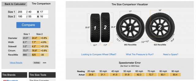

So my extremely limited knowledge on offset says that my new wheels at 37.5 are going to be MORE outboard, correct? In which case, make it more likely to rub with a taller tire, correct?

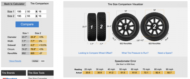

Here's some tire size comparisons I did. OEM 205/40/17 vs 195/50/16 vs 195/55/16. Maybe the 37.5 offset will change my/our thinking, but I feel like the 195/55 is going to rub based on how little room there is in there on the stock 17's. Anyway, please take a look at these pics friends and tell me your thoughts
Stock rims vs: 205/40/17 vs 195/50/16
195/50 vs 195/55
Stock rims vs: 205/40/17 vs 195/55/16
Look at this last image. 195/55 is a full extra inch of height from oem full wheel diameter, but by dropping rim size by an inch I do get a FULL inch of extra sidewall. But still, 23.5 to 24.4 total diameter seems like a big jump to me. Maybe your offset @Dialcaliper allowed you to pull this off?
195/50 vs 195/55
(@Dialcaliper @M-Sport fan @asidrive @tri-pedaler )

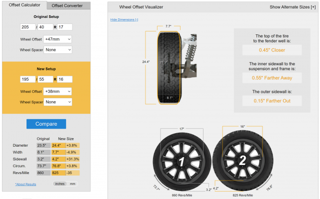

That same website has a much better "Tire Offset Calculator" that lets you put in both the tire size and the wheel diameter/offset and does an overlay
Link
https://tiresize.com/wheel-offset-calculator/
For example, part of why I picked the 16"x6.5" et38 wheels (instead of a et47.5 wheel I also found for my 195/55R16 snow tires is that the 38 offset puts the outside face of the narrower tire very near (~1/8" out) where the outside wall of the OEM tire sits (instead of having the same centerline with a narrower tire). They poke less than the 215/45R16's on et42 wheels and those of course fit fine even on most FiSTs lowered at least an inch.
I will say that I did a lot of research on this same topic, and while you can get away with 1" additional tire diameter without rub, that's really at the limit, and anything too much wider than 195 tire may run into issues at that sidewall height. I would also not try to run the 1" taller tire on a car that's lowered much below stock height or you will likely rub. But presumably that's not what you're after in a RallyX setup
Below are the numbers the snow setup I'm using along with the shortened mudflap nuts. As is, there's a minumum of 3/8" clearance to the nuts with the car still and so far I haven't had any rub issues on snow or dirt. I had them on the stock springs for a bit and they seemed okay - the new spring setup also means slightly less bump compression than stock so it also helps a bit there.

Yes, at that offset (ET 37.5) the tire (tread and section) width will have more relevance in whether or not it rubs against those flap mounts as the height will.
Although Dialcaliper is absolutely correct in telling you that 1" taller than the factory setup's height (i.e.; 24.3" tall or so) is the max you should attempt, whether on factory suspension, or even a raised aftermarket suspension, due to the wheel travel, and severe compression bumps you could face in your RallyCross use.
Once I removed my Rallyarmor flaps, my street setup 16x8s even with their ET40 and wider than most others out there, 24.2" tall 205/50-16s never ever (even on tarmac big dip compression bumps, or severe braking), rubbed at all.
It might not rub once I do the 'Dialcaliper mod' to those flap mount hardware pieces, but I won't know until I get the chance to try that, with the re-install of said flaps on my ride.
Link
Wow. The offset calculator on that site is amazing. What was already a pretty darn cool website is even radder knowing the offset calculator is in there. Thanks so much @Dialcaliper for the heads up on that! Serious game changer and peace of mind using that feature.
How much off-roady / rally stuff have you and @M-Sport fan done with this setup? My concern is that even using your high speed tarmac compression on a dip as an example where the car didn't rub, I feel I may still have deeper suspensions compression on a RallyX course. I will say though that I had a wheel rub issue in my 84 911 Carrera (low-key flex) and that issue only liked to appear on super high speed deep compressions like what you described; so I agree that in itself is a solid anecdotal metric.
I stuck a tape measure between the top of the OEM wheel setup and the top of the front fender well and it seems like there's roughly about 3" inches. So losing a half an inch there doesn't seem like it'll be too bad? And the outer sidewall being .15" inches further out seems nominal enough not to worry either. The plastic in the front fender wells seems pretty easy to work with too, were I to have to make some modifications. (Fender well clearance in the rear was closer to 5" inches btw so no real worry there I suppose)
So all this and what has been said above, I'm gonna try the 195/55 (the low pro nuts for the flaps arrived yesterday). I was talking to a Porsche friend who is a helluva wrench about all this yesterday and he said, "How much are these tires?"
