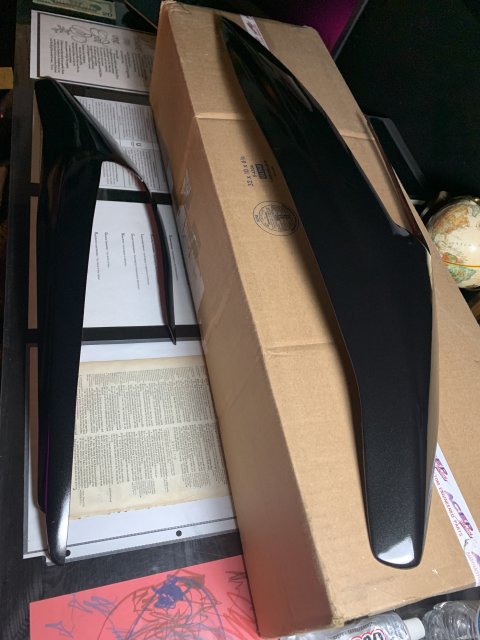

Purchased a set of “stanky style” ACEP Styling headlight eyelid dealio majobers that have been sitting in my basement waiting for paint for about 2 months now. Finally received my color match paint to get these glossed up and on the car. Here is a brief overview/prep path to get this done.

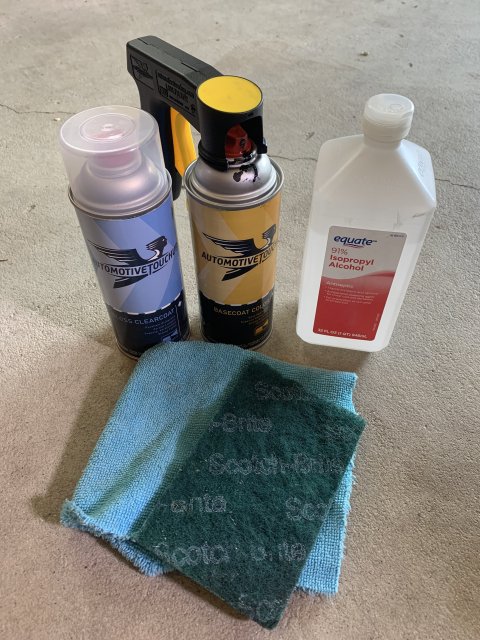

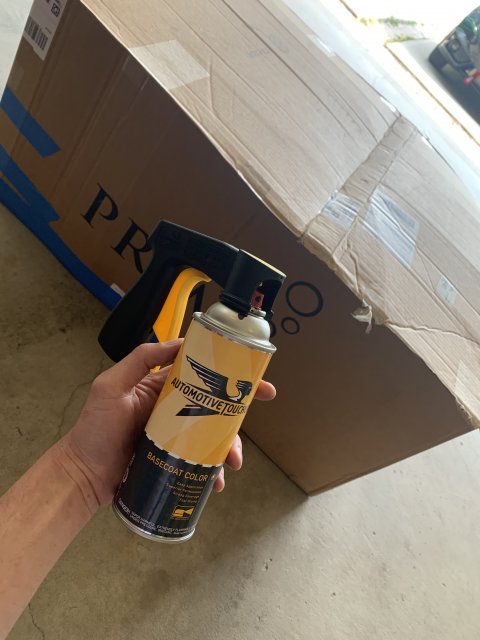

First hit up a color match paint distributer, in my case the basics like Diplocolor did not make my exact match. They did have something close (universal metallic black) but I wasn’t about that. Wanted something just right and OEM. I hit up automotivetouchup.com to get what I needed. Was like 45$ shipped for a can of base coat paint, clear coat And a spray gun adapter for rattle cans. Took about 2 weeks to arrive.
As you can see, I also used some alcohol and a scotch bright pad. Scuff up your preprimed body piece and then clean with alcohol (hit with tac cloth after if it makes you feel better).

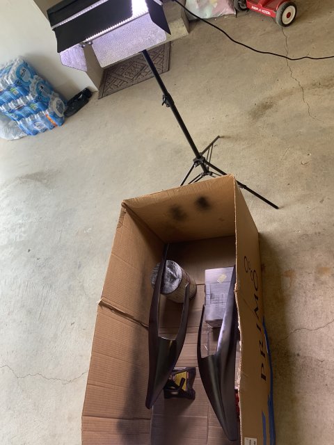

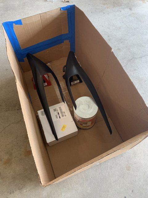

I made a little paint box to avoid dust the best I could. Taped some boxes together to get it large enough. Used another piece of cardboard as a lid between coats to further aid in inhibiting contamination. Elevated my pieces on some floor jacks and random crap :)
I would recommend getting some good lighting as you’re working, I had an LED photography light panel... some of you might have a flood light or something. Get er out, you’ll thank yourself for catching contaminants with lighting between coats.

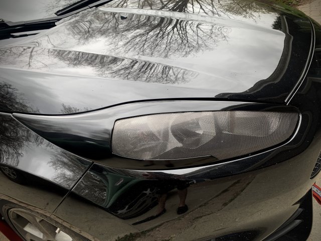

Here’s finished product curing:

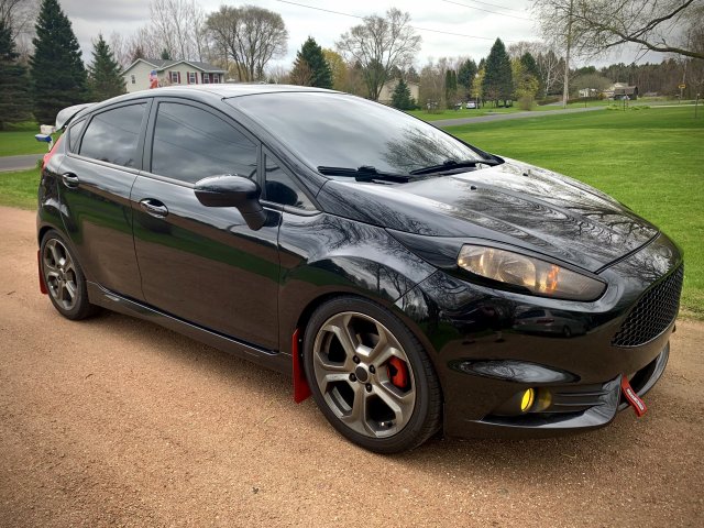

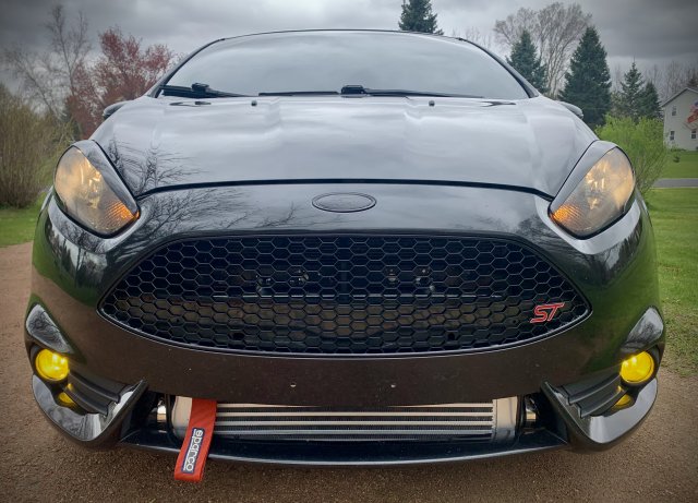

Indeed! Should be fine to put on tomorrow night but I’ll probably wait another day just cuz. I’m curious how well they will bond to my headlights with the double 3m tape considering I now have a wrap over my headlights. The wrap is that fly eye biz though, So it’s perforated. Hmmmm.... hopefully they don’t fly off on the freeway! Bye bye $$

I like the fly eye stuff. Where did you get it? And how bad does it reduce light output? I think id like it on the headlamps, tail lamps and fogs ( when i get some new led fogs).

eBay two rolls for like 12$ from China. MOT compliant and I didn’t notice any difference in light output. Seems equal.
