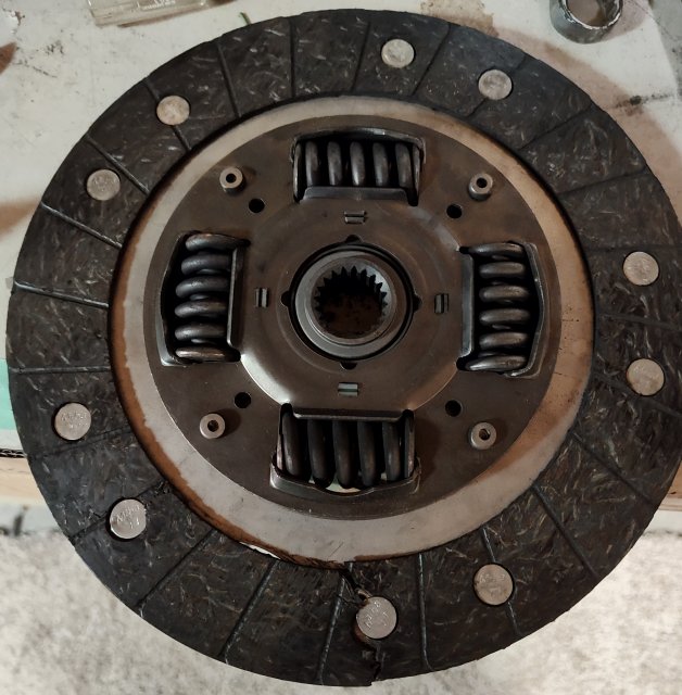

Update:
Found what appears to be the issue.
Slave cylinder looks to be a little tired, but the main issue was my clutch started to come apart. It's an RTS twin friction and not sure if I did something to hurt it or just got unlucky as it only has about 11K miles on it.
Flywheel and pressure plate look great, no scoring, grooves, etc.
Have a new OEM flywheel and Whoosh stage 3 clutch on the way.
Edit:
Spoke with RTS and they said the likely cause was exceeding the rated torque on a hard downshift. This makes sense as downshifts on track can be a bit spicy (still working on it). Hopefully the Whoosh clutch will take the abuse as my ST is predominantly for track duty these days.

Final update,
New OEM flywheel, Whoosh "Sponge Bob" clutch/pressure plate, RTS slave cylinder installed.
No more issue.
