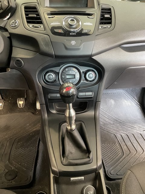

Couple new things on the way - Unicorn S284 kit Ron magically found, @grey fist‘s custom shifter and a titanium reverse lock out from LatheWerks to match my shifter extension.
Still in the garage waiting to be installed - TB 4-point brace, Maxton splitter, Radium ccv side catch can.

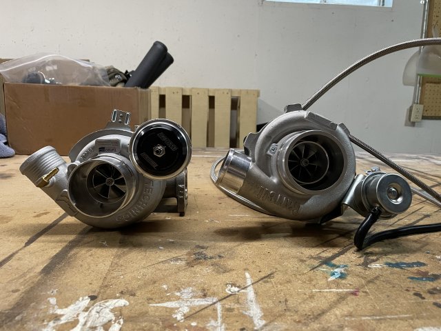

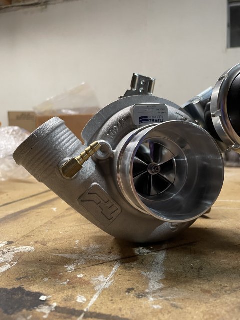

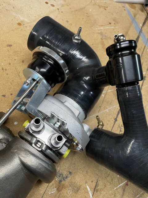

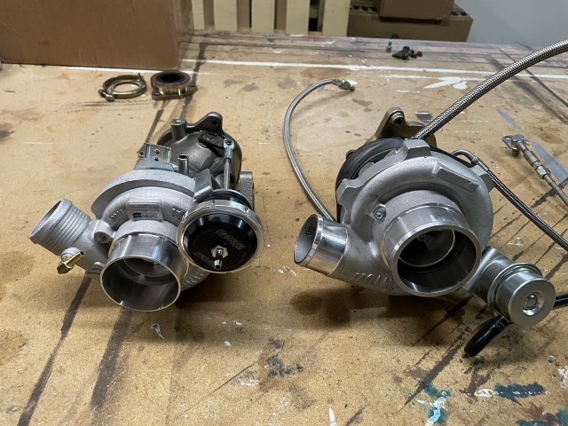

Thread Starter #46

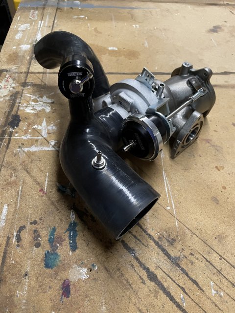

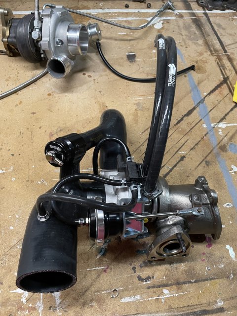

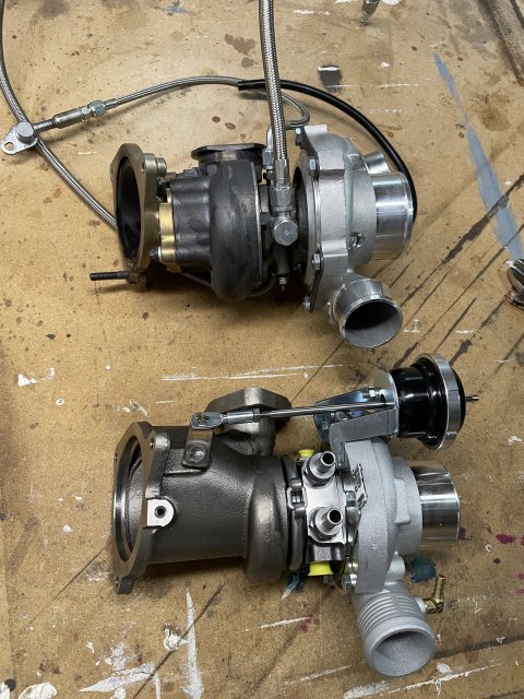

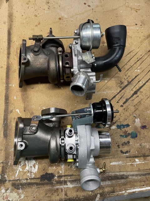

Unboxed the s284 today and test fit the inlet and compressor outlet with BPV. Kit seems very well thought out and fits up seemingly perfect. A little disappointed the inlet has the quick tap not the molded silicone that’s in all the pics but that side doesn’t see boost so whatever.
Pic next to stock turbo for size reference. Will do the same with the 2860 once it’s out.

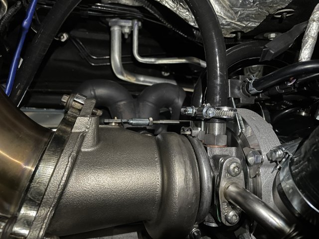

Took it slow and did the S284 install over the course of a few days. Super smooth overall with the exception of the oil drain line going MIA which required an impromptu ride to Ford. Had two furry copilots for the trip.
Bummed the ARP turbo to downpipe studs didn’t fit. Had to reuse the OEM hardware but hey now whoever buys my 2860 is getting APR hardware with it.

I might have missed it, but why the turbo change?
Quite a few reasons, but mostly that I love the 2860 powerband and trust Garrett reliability/warranty more than that of the S280. I bought the S280 in a moment of frustration that I had to pull the 2860 again to adjust the IWG pre load but all in all, I like the 2860 better. It was my first choice from the beginning so I feel good about the S280 experiment and even better about keeping the 2860. Granted it took finding the WOR manifold and adding a Mountune hot side pipe to replace the ATP one to make the kit what I want, but I feel it's damn near perfect now and has more headroom for sure if I ever add aux fuel or hpfp/injectors.
