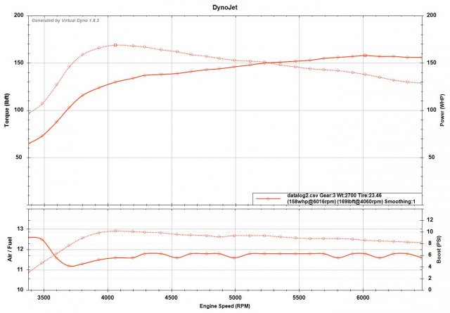

Adventure keeps getting more interesting, unfortunately.
Quick taps installed so the solenoid could get plumbed in. No CEL, but boost is peaking at 10 psi and quickly falling from there down to 8 psi by 6500 rpm.
Ordered a boost leak tester to see what happens there before I go ripping the turbo off and chasing down an incorrectly pre-loaded wastegate. Should have the tester Monday if Amazon comes through like usual.
Here's a comical VDyno and datalog attached to show you guys what's happening. Would love any thoughts what to go look for other than boost leak or wastegate pre-load.

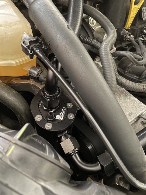

Installed Radium OCC that’s been chillin in the garage untouched in downtime. Fits great. Will install the CCV side catch can in the next few days if I find myself bored.

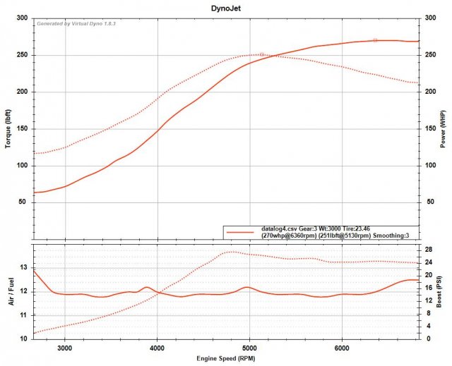

Quick update here with the latest VDyno on version V1F of tuning. Car absolutely rips above 5,000 rpm but the slow spool is a huge bummer.
Wondering if my IWG actuator is the issue. It's a 14 psi gate but is cracking open below 10 psi. Not sure if exhaust pressure alone is enough to force the flapper open and slow down the spool but have confirmed no exhaust leaks before the turbo.

Jason @ Dizzy confirmed - the last log is all we're getting out of it. I could adjust the IWG actuator and machine the vband adapter and get spool down a few hundred RPMs.
On another note, I just ordered an S280 from Ron. He said 1-2 weeks out on inventory as supply chain issues are clearing up now. Nothing wrong with this setup but after a few hundred miles on this thing I'm missing the fast spool of stock turbo. Will have a mint condition 2860 kit for sale in a few weeks pending delivery of the s280.
