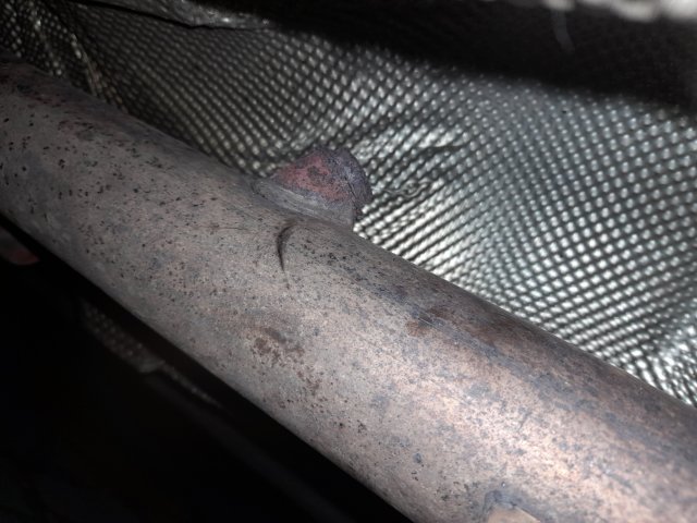

I purchased a 2006 Fiesta ST. Engine light was on so I assumed it was an o2 sensor. Turns out there is no cat or no second o2 sensor it has been blanked off as per picture.
Now, from what I can make out I can remove the blank that is put in o2 sensor hole and insert a defouler. The defouler then connects to the o2 sensor which plugs in as normal.

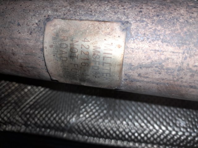

Milltek, nice. That’s a nice piece of hardware.
Yes a defouler and putting the O2 sensor will clear the check engine light. Can’t say for the MOT though.
You could always replace the downpipe with milltek catted version if you want a MOT and check engine light fixing solution.

The cheapest way to fix all your problem's and get your MOT is replace the down pipe with a stock down pipe and O2's, stock down pipes can be had used on E-bay.
