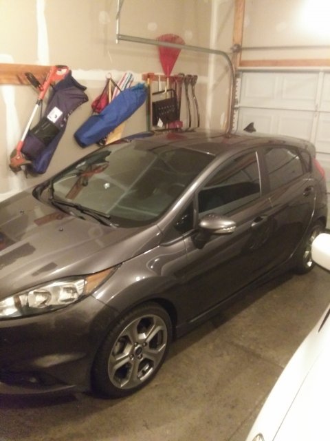

So here's a bit of an update. I got the "shark fin" antenna today. It fairly easily slides over the existing antenna base and seems match the contours of the roof. It leaves you with a nice overlap around the edges of the antenna base. I would guess probably at least 3/4 inch on every side. I'm not ready to permanently attach it yet, as I'm having a friend's shop look at it later this week to see if they recommend any "prep" first. Linky to product: https://www.amazon.com/dp/B01MCZ6ROE?psc=1&ref=ppx_yo2ov_dt_b_product_details
BTW, I'm now calling the car "Jaws". My wife is calling it "Baby Shark". :confused:
