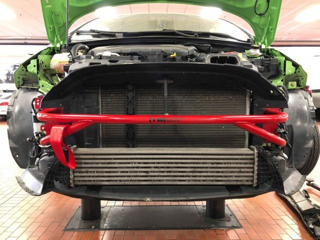

TB Performance Products has the crash braces front and rear and other braces to control torque steer and improve handling. Fiesta-ST-Front-Crash-Bar-3_1024x1024.jpg

Not bad! I'd like to have the white one. $500 isn't too bad if insurance will cover in a worst case scenario.
Would you happen to know?
According to the owner, he has had several clients get into accidents with no insurance problems, but I would think it would depend on the company and how bad the accident was. Serious bodily injury or death would play a roll.
Yeah def makes sense.
I mean if it was my death it wouldn't really matter cuz I'd be dead but good to know LoL
As long as if I live my crash bar wont be blamed for the other persons you know... LoL

I have this strange feeling that, that crash bar can probably take more of a a beating than the OEM one LoL
My thoughts also.
Will the airbag sensor stuff still work?
Good question, he did not talk about factory sensors, but it should not be hard to mount.
That's not the point. The whole front of the car including the crash bar is designed to be a huge crumple zone when you get into an accident; absorbing the crash energy so that your body does not. Changing it for a more solid crash bar changes the whole dynamic of the crash/crumple zone and likely not for the better but who knows it's not like anyone's has ever tested the aftermarket bars to compare to the original.
That could very well be the case, but that will not stop some insurance companies from arguing it was still at fault by not being subjected to, and passing all of the same various NHSTA/DOT crash tests/regs as the factory boat anchor 'beam', and therefore trying to deny payouts on any/all claims where this part is involved.

As mentioned, changing it out for a tubular crash bar, will increase air flow and etc. However you run the risk of totaling your car from an accident that may have otherwise not caused as much damage. The OE bar crumples and displaces energy though it, a tubular will transfer much more energy to the frame rails that it is bolted to. This can cause severe structural damage in the event of an accident. We run one on our track car, but I would not for a street driven car.
