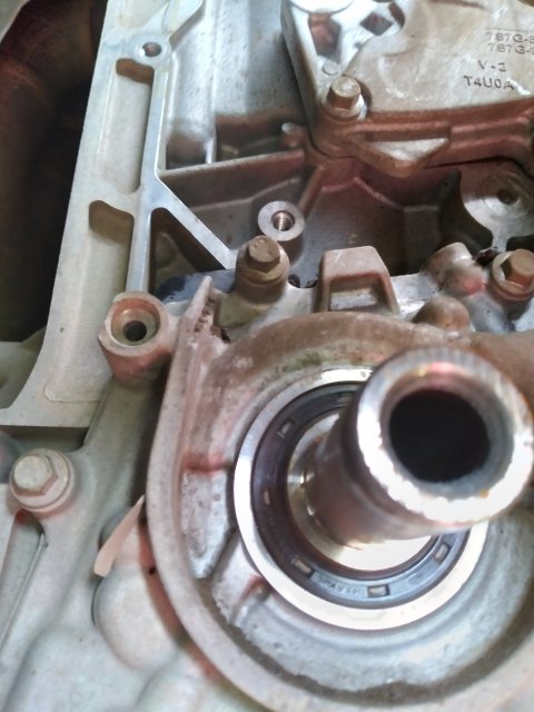

Putting a new timing belt on 2016 ford fiesta st. 1.6 All the information I can find the crankshaft sensor shows it by the crankshaft pulley, but mine is next to the flywheel, is anybody have this problem?

I will post a picture where I pulled the crankshaft polley off tomorrow

I will take a picture tomorrow
I would like to see this.

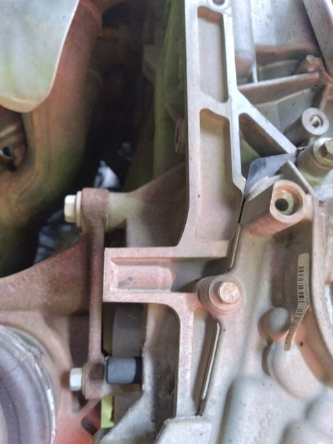

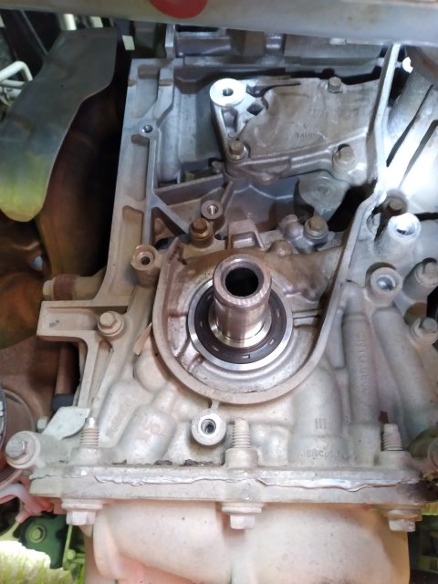

Is that engine out of the car?
Is it possible to get a photo from further away to get a better perspective?
Your photo shows that you have the lower pully/balancer off.
Can you provide a photo of the back side of it as well?

Come to find out, talked to ford place where we got the car the engine is a dura-tex 1.6 with 16 valves and the crankshaft sensor is by the flywheel
No it is not out
