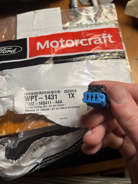

So I need a new connector for my crankshaft position sensor (long story that involves me driving across things I shouldn't) and I found this one.
https://parts.ford.com/shop/en/us/e...osition-sensor-connector-wire-p-wpt1431?pdp=y
Can anyone confirm that this is the right part?
The part number is WPT1431.
Also why are all these wiring pigtails so expensive?? The boost sensor pigtail that I had to buy last year was $80, this one is $60! :mad:

Alright, here to answer my question for anyone else dealing with this. WPT1431 is correct.
A couple strains of my accessory belt broke (probably due to a rock or some other debris) and the broken piece hit my CPS connector until it broke it, which prompted the car to shut off entirely. We taped it together enough to limp it home and today we replaced the connector and belt.
