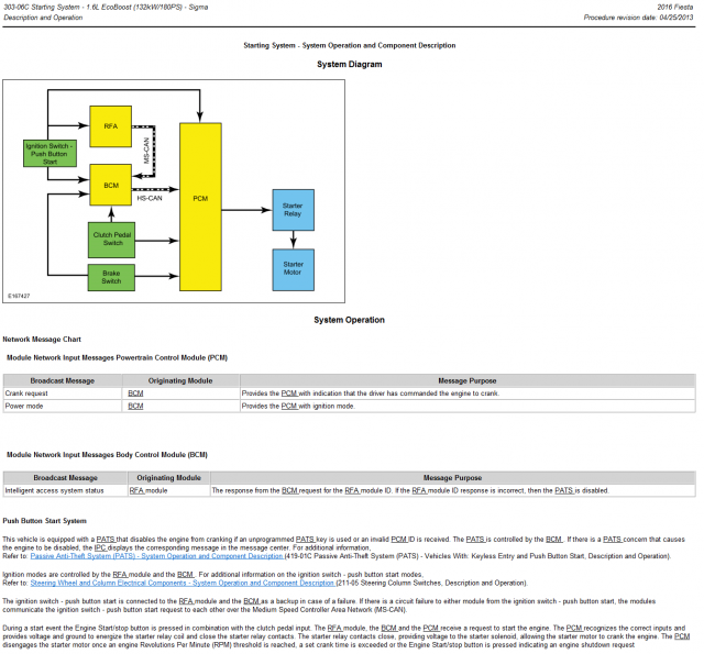

As "smart" or thoroughly engineered as the ECU is, it seems like a certain amount of cranking with no crank position sense would eventually set a code?

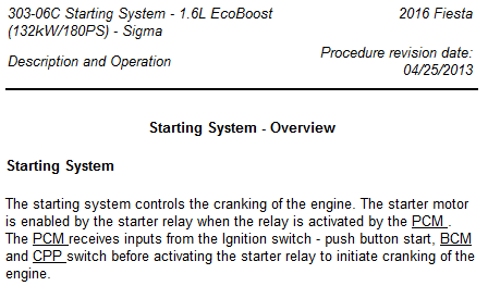

CPP = Clutch Pedal Position
So by the fact that it's cranking, it's at least getting through the above.
Question is, would the engine still crank without authorization from the security system; or would it allow crank but just not start?
3,905
2,444
<<........... The PCM disengages the starter motor (relay actually) once ............ a set crank time is exceeded ....................>>
Before reading the codes, allow the PCM time to stop the crank on its own. Perhaps this will set the code?

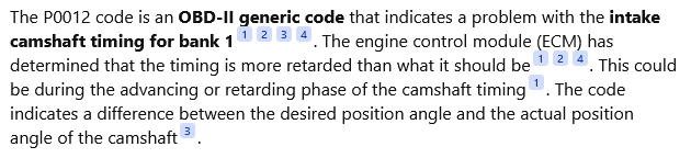

So, I did see a stored P0012 in my INNOVA code scanner. It's been coming up before oil changes and then going away.
I'm not counting this as a recent code because the car would drive with it up.

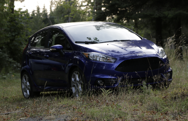

Oh, here's my beast. 2015 Performance Blue.
It's been a great car, one of my favorites. Only has needed oil changes and brakes until now.

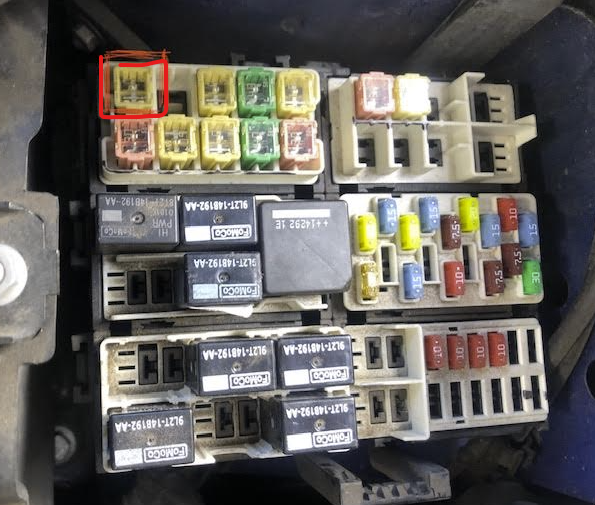

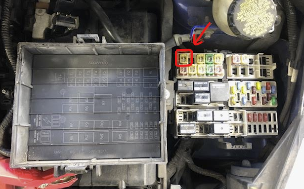

So what was the FUSE you pulled?
This is the fuse... at least I think it's a fuse.
I'm used to looking at the traditional blade fuses. These fat ones don't have test blades sticking out.
Doesn't seem like a breaker, though.

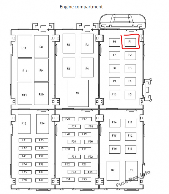

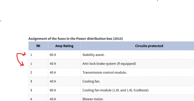

So it was this one: F1. Interesting that the online diagram has two different entries for position 1.
Both stability control and ABS are listed.
I figured pulling this one would possibly cause the ABS system to reset or not be active.
Car stopped running. Put the fuse back, no start. Might be coincidental, or I screwed something up. We'll find out.

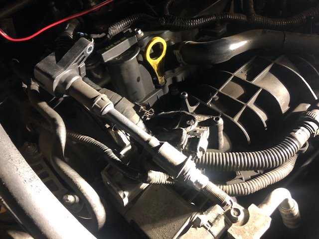

Well. Seems like there's spark.
I pulled a plug and coil, and rested the plug base on a bracket.
Tested voltage with the multimeter from battery pos. and the bracket going to the meter. 12 volts.
See video attached.
Next step will be the Forscan app, I guess.

Do you have an owners manual? If so does it have a fuse layout diagram? What listing does it show for the fuse you pulled?
No, not yet. I looked for a PDF or online download, can't seem to find anything that looks like a pro product.
I found the fuse diagrams online. Check my post above. I believe it was 'F1' in the engine compartment fuse box.
