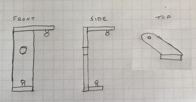

I have the same tilted 1-2 shift like everyone else. One day when I feel creative I'll make up a replacement linkage that centers the tie rod when the shifter is centered and also rotates the shift cable back to horizontal. What I'm thinking is a piece of 1/4" thick steel with a 90 degree bend at each end or maybe some thick aluminum TIG'd together. Should be fairly simple; just need to keep the lever arm ratio in the ballpark of the stock piece.
Can offset the bearing hole like stock as well if using wider material. Not sure if that's necessary or if there is enough adjustment in the front-back tie rod to get the shift knob in a good location.
edit: New quick and ugly sketch. Just occurred to me I can cut the upper tab at an angle before welding to recreate the offset. Might give this a try next weekend.
True, the issue with the 6th was very fast to solve.
The sketch looks awesome, I'm really thrilled if it will work out!
