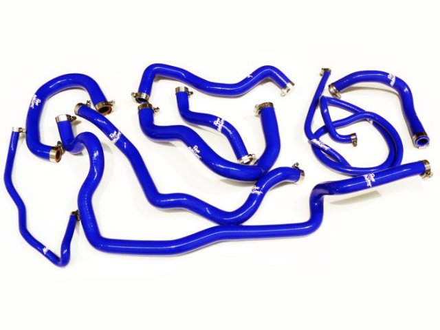

I would like your opinion..I have a 2013 Fiesta ST and it is for the coolant recall (17S09). Because I don't trust workshops in my country for this work, I ended up doing it myself with some spare parts..
I've taken
Silicone Ancillary & Breather Hose Kit from roose both top header tank hoses.
Ford thermostat 82 celsious (whoosh 180F)
and I'm thinking of getting the airtec or pro alloy expansion tank and a radiator (airtec or mountune)
Also via obd I already check the water temperature with an alarm at 105 celsius (221F)
Do you think with this option I will face any problem in the future? So far I have not faced any overheating problem but I am definitely worried about a recall
I have read on the forum that the recall in essence does not solve the problem and as a precaution they change the pipes and the expansion tank with the position sensor for an alarm in case of coolant loss
I am also attaching the pipes that I already have in case someone more experienced than me knows if they cover the cooling system
Sorry for my English.

Since you must remove the bumper cover anyway to access some of those hoses, I would seriously consider swapping out the radiator for one of the bigger capacity aftermarket deals. [wink]

Thank you for your replies...
Yes, of course I'm thinking of getting a bigger radiator (mountune, proalloy) or the airtec, where I can't find much information about it together with an aluminum expansion tank
I was just wondering if with all this material everything will be fine.
**I already got Silicone Ancillary & Breather Hose Kit from roose both top header tank hoses.
Ford thermostat 82 celsius (whoosh 180F)
obd (ultragauge) to monitor temperatures with alarm
