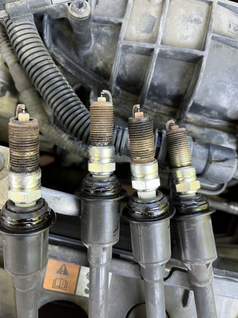

My day has come. A mix of oil and coolant on my plugs. Car seemingly has been driving fine except I noticed white smoke at start up, and my coolant reservoir constantly needs refilling.
Spark plugs are laid out in the same position they were in the car. Passenger side on the left was difficult to loosen and smells strongly of sweet coolant. #3 smells like carbon.

Pushing 166k. New spark plugs went in fine. I thought #1 may have stripped because it was so tough to get out. Going to switch back to 93 and not go WOT until I can get it to a shop and see what the damage is. I know repairs are overall cheaper than a new car, but I won't lie, a new DD was sounding kinda nice.

Has the car ever been overheated? Did you do the head recall for that year? Also what tune were you running?

Car has never overheated (and I live in Texas), I don't believe this car was ever recalled for the head, and I've been running mostly E30 for the past 4 years.

I had this happen on my Mazda5 minivan back in 2018. The remedy was replacing the valve cover gasket. Also replaced the ignition coil that was ruined by the coolant leak.

Shop confirmed exhaust gases in the coolant system. They haven't gotten me a price yet, but he said either way, bad head gasket, or cracked cylinder, they won't know until they pull the head. Should have a price tomorrow. Not sure this car is worth going through the trouble for besides the fact it's paid off.
