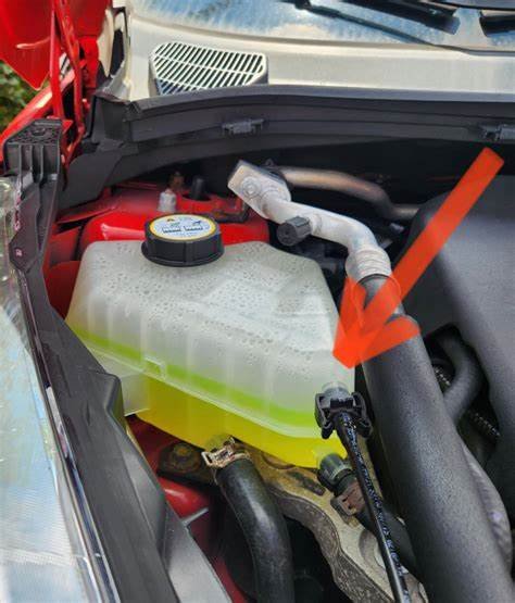

This car has a very complicated cooling system. When you drain it, will only get about half out.
Even then I spent months topping off after a coolant drain/swap. Guessing part of the reason may be, it's not entirely about how many drive cycles it takes, it's the peak temp for that drive cycle.
There's a little hose at the top of the reservoir... (somebody else's photo)
Anticipating the need to bleed and add more, especially on my first refill, I kept adding more and more, allowing coolant to run down that line. Air would bubble the coolant entering that line. It seemed to take a lot. This greatly reduced the number of post service necessary top-offs.
This most recent refill though...
