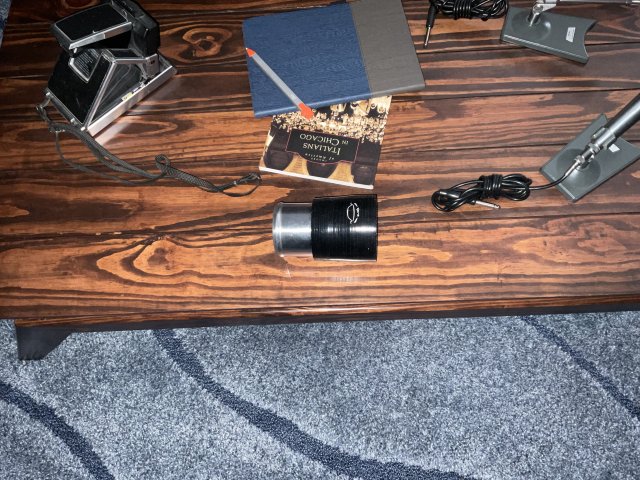

that is exactly what I did along with a short 2.75 inch pipe to connect to the Turbo technics 2.75 hose coming off my turbo inlet. image.jpg a pic I took before putting it in.

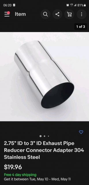

I grabbed something similar to this although my situation is different with a whoosh and airtec elbow. Mine also isn't bead rolled but if I end up using it should be able to find a place to bead roll it.
