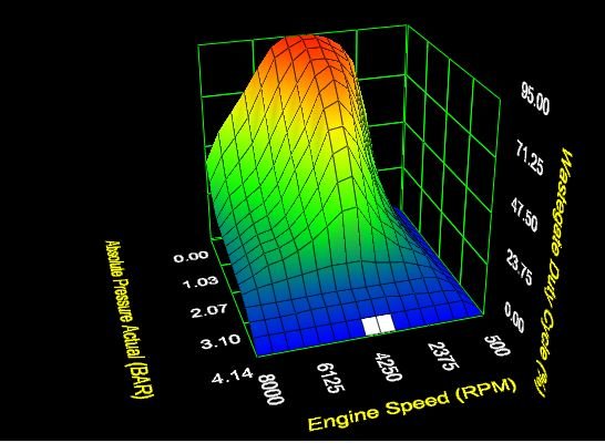

Attached the CCF RPM/MAP WGDC schedule 3D which I ended up with designing with a lot of trial and error (using MAP for X axis as it's changeable).
