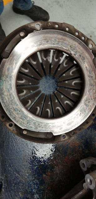

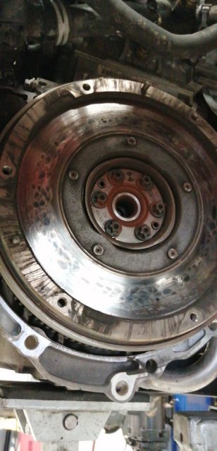

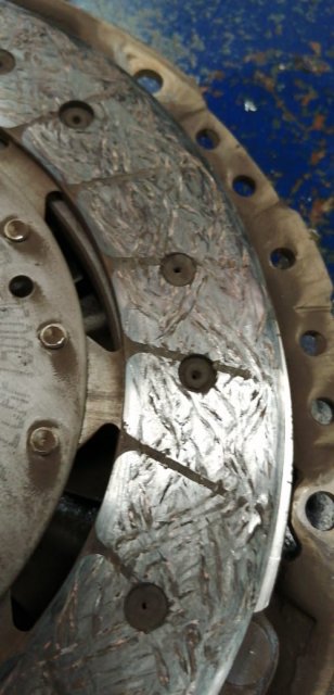

I had the same issue in February while snowboarding at Big Bear. Clutch pedal was getting stuck up the mountain. Leaving Big Bear, the clutch fully depressed and would not come up. Car was towed back 78 miles. Mechanic near my house ordered a new clutch kit and the OE lasted 141,020 miles.
