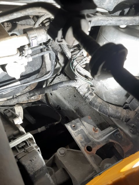

Hey there, my 2014 is leaking hydraulic fluid from the fitting right at the fire wall. I want to try replacing the short piece of hard line and see if that stops the leak, but I can't find the part.
1. Does anybody know the part number?
2. Do you think that would fix the problem?
3. What else could I try?

Remove the tubing and look for cracks or burrs and re install and see if it stops. New line can be bent and flared.
