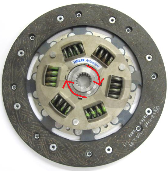

My sons 2014 had its original clutch fall apart. The inner ring/gear separated from the rest of the disk allowing it to rotate freely. It had chatter symptoms before it completely let go. I think it is something that used to happen semi frequently with that years clutch. Doctored up a stock image clutch disk to show what I am talking about.
