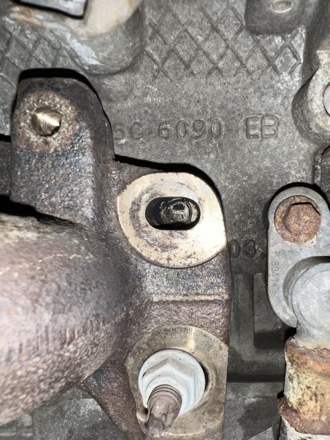

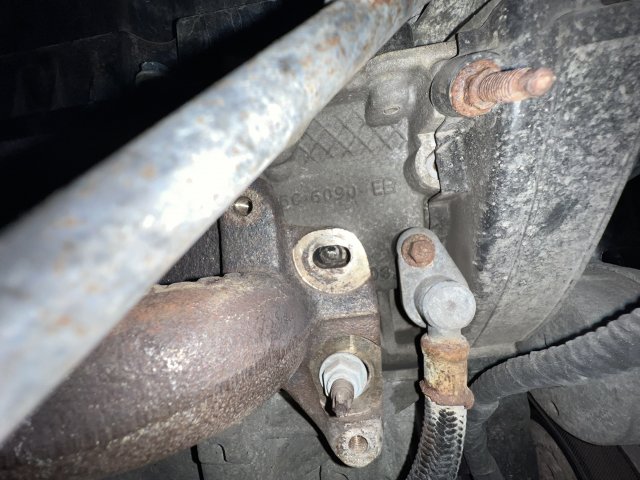

To follow-up on this, I'm confident I have found it the problem.
TL;DR : Broken stud between the block and the exhaust manifold.
Overall picture with context.
Closeup of the broken stud.
Since the stud looks to be broken after the center portion of the stud, my chances could be a bit higher since no torque is still applied on it.
I'll have to order a new oil feed tube it seems...
Symptoms from the service manual seem to indicate this as well.

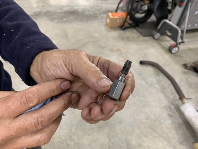

Easy Out, or some other method of extraction?
Here is the post in detail.
We used this tool. We had several others, like the Grabit and Grabit Pro series. It worked great for one of the two studs. The other was starting to approach scary territory of torque required and we decided not to proceed and simply tap the existing material in the head. This stud of course is going to be less strong, but it did hold in the end.
Unfortunately, it later broke into the turbo manifold housing, requiring us to use a carbide burr bit to clear it out before drilling to size and re-taping.
