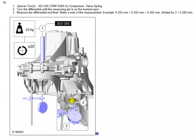

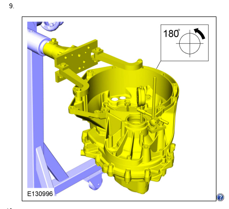

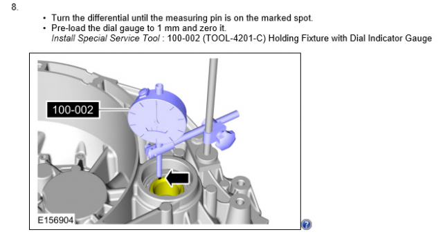

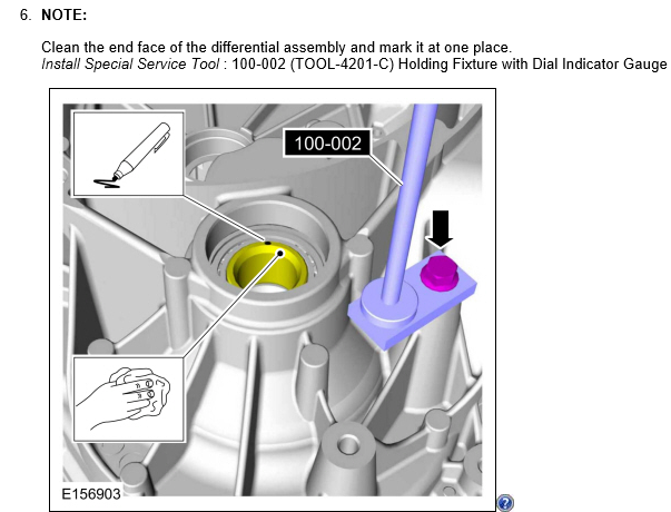

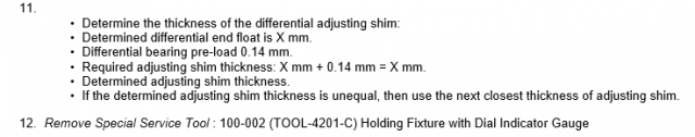

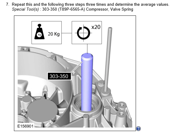

Just read your report of what the shop who did the work told you. This is the reason why I'll be installing the differential if I ever decide to take that step. Ford has a very specific procedure for installing the differential and IIRC it requires the use of shims and a certified straight edge supported between specific points on the case. It's obvious to me that Ford's procedure was not followed and I would not trust this install as far as I could throw a FiST. Hopefully the dealer will have a technician that will actually follow Ford's procedure for checking this install. As for the cost, if they do find the install wasn't done properly I would be asking the shop who goofed to pay for the correction. If they don't want to do that take them to Court.

Ford's procedure takes the effect of heat into account. It's one reason why the instructions are so specific. Unfortunately my service manual is with my laptop at work so I can only comment on what I remember when I scanned this procedure well over a year ago and my memory is not as good as it once was.
