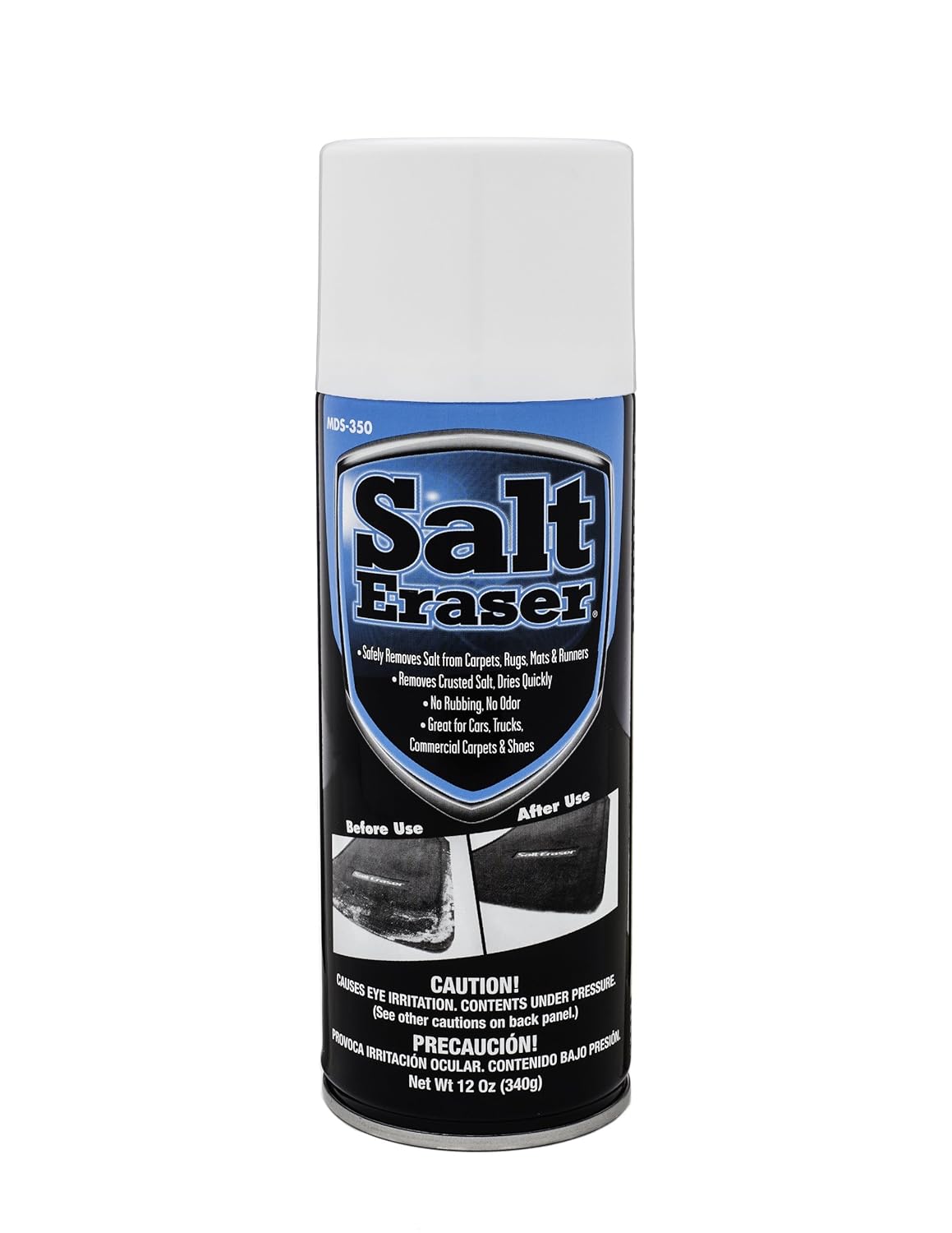

I've done the 50/50 solution before and it does work but your car stinks for a few days. Haven't tried the salt erasure but I have read good reviews about it.
188
14
Baking soda will get rid of the smell. Just dust the carpet with it then vacuum it up.
As for salt eraser I have it. It does well on light salt stains but if you have heavy built up deposits it doesn't get rid of those.
