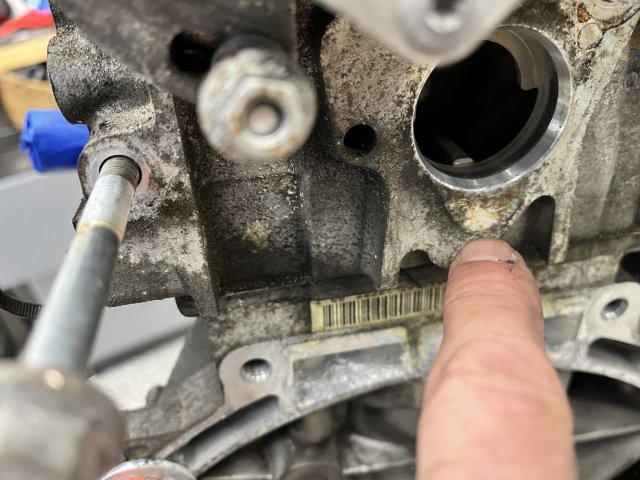

Trying to install a 2018 FiST motor in a 2015 FiST.
The old motor appears to have a cylinder head temperature sensor … the new motor does not.
Did the new motors forgo those sensors entirely? If so, can I have this accounted for in the tune?

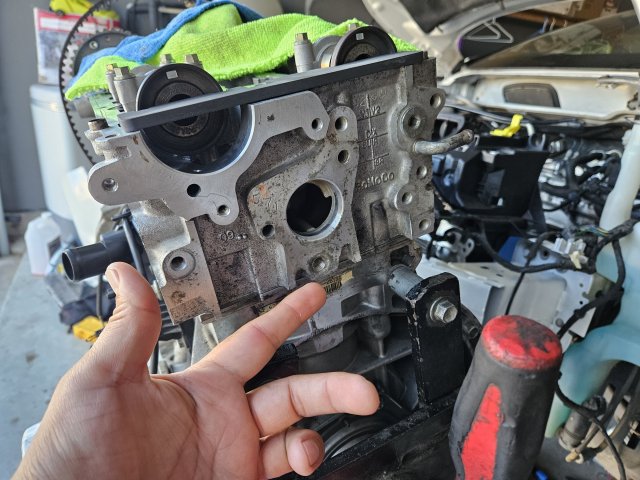

As for the sensor, turns out that I likely got a 1.6 Escape motor, which I guess didn't have the same sensor. The motor has since been switched out with a correct one from a FiST.

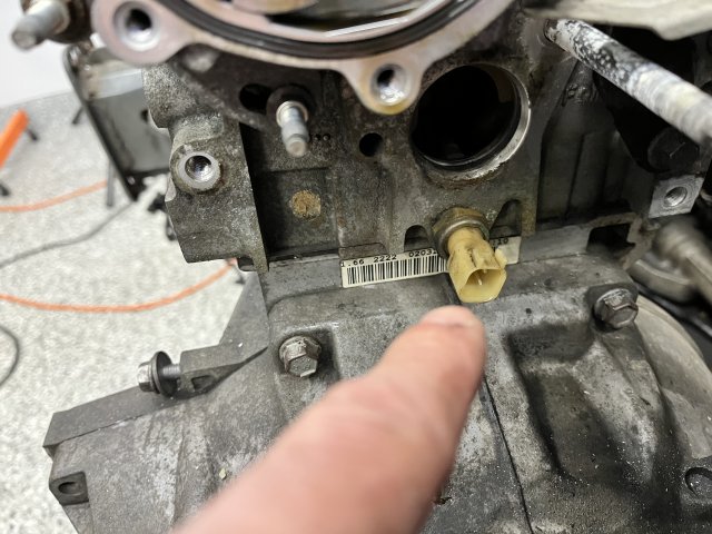

I know this is an old thread, I'm in the process of buying a used engine for my Fiesta. I freaked out reading this post thinking the newer escape motor with a coolant temp sensor in the head would not work since I have a 17 fist and the engine should have been revised from ford. Well as it turns out my 17 DOES have the provision for the temp sensor in the head.
The OP had a 15 fist which probably had the revision already done (late 15 build?). The engine pictures without the hole was probably an older head desing from 13-14 year model escape, fusion or fiesta.
I hope this helps other fiesta owners looking for swap information.
Here is a picture of the engine out of my 17 fiesta.
