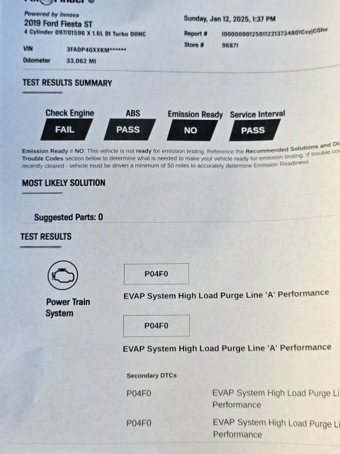

Went to autozone, 0.5 miles away from where I was and decided to get it checked since I couldn't find my old OBD2 scanner, attached is what they could find.
Doesn't look like it's a common issue for the fiesta ST after trying to search the forums. It looks like it has happened to other Ford models however. I still haven't been able to find an answer anywhere as to what it could be though.
It's a 2019 with 32.9k miles, only mod from what I can see is a whoosh intake tube. Will be going to the dealership, but for now, has anyone else run into this issue? Any help or insight is greatly appreciated as always!! Fiesta light.jpg

Today i finally got the chance to drive the car, but the check engine light came on for a THIRD time within the past month or so.
I got the same exact DTC code as I did last time.
As you can see from the picture, I've driven the car roughly 60 miles since I last had it.
I am DESPERATE now, as I haven't had a single day where I could enjoy this car since buying it on November.
Has anyone had this issue / DTC code before? I am desperate for answers or any lead.
So far the dealership has replaced the air intake hose, and the purge valve in the past month.
Any help or advice would be GREATLY APPRECIATED.

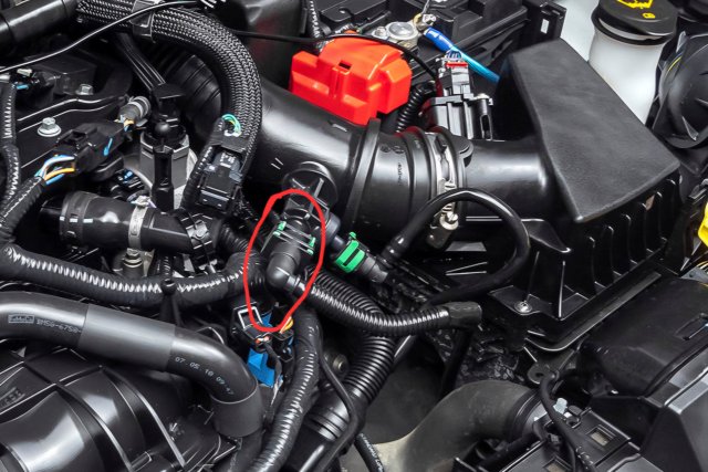

Hi everyone, thanks for the replies!! I'm currently at the dealership and requested to see the car while it's being looked at by the tech.
I will also bring up the canister near the fuel tank, and the fuel cap or related parts near there as well.
But before i came in, I thought I'd take a quick look at the engine bay for anything worth bringing up.
The purge valve and new OEM air intake hose that were replaced last month because of the same check engine light, all look fine and connected, so no issues there. But I took a close look at the intake and wondered if you guys have a connector here? I am not sure what it's missing and if it's evap related or not. I only found 1 or 2 pictures online on a stock engine to show what i'm talking about.

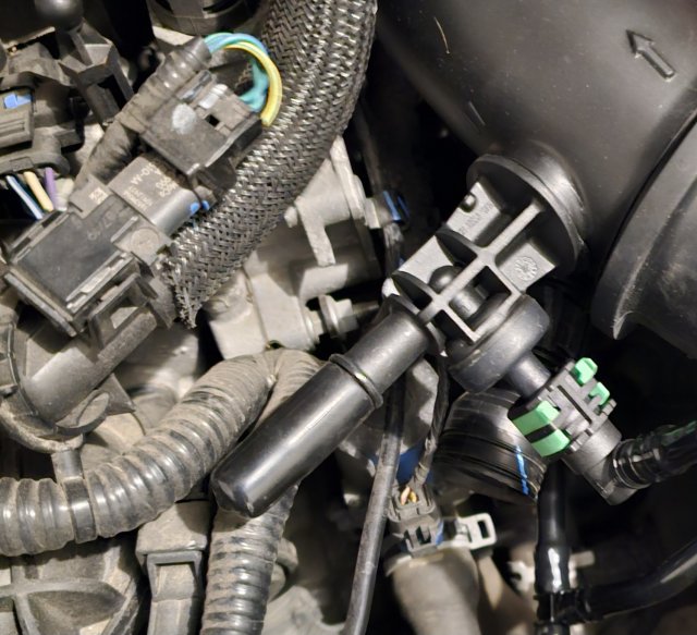

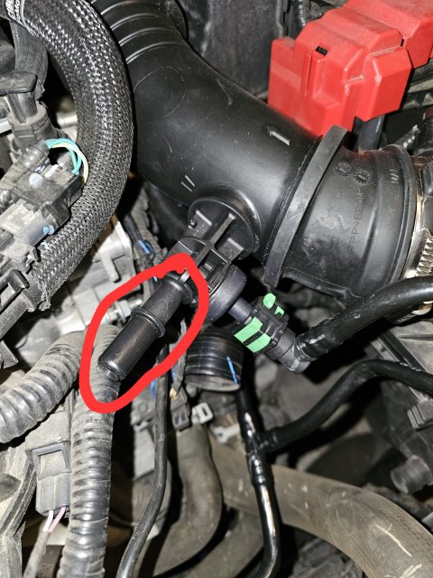

Would anyone know what's supposed to be connected here? It's connected to the air intake.
Here's a closer look and after I removed the cap.
And here's the best picture I could find online, it looks like there's supposed to be something connected there.
Thank you as always

Looks like the previous owner "converted" the evap harness assembly to the older style and capped off the extra connector. That assembly also connects to the cold pipe which is basically between the driver side intercooler and the throttle body. I would make sure that connection is secure. I would also mention that to the dealer. Tell them thats the incorrect evap harness assembly. Maybe they will put the newer style on that has that connection built into it.

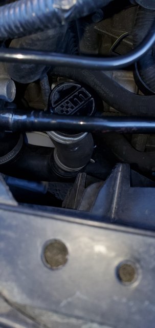

Another update from today, the dealership ended up saying that the car needs a blow off valve most likely as the check engine light is coming on at higher speeds / high boost and throttle (which aligns with what I've experienced)....but I was a little lost or maybe I misunderstood, as I let them know that the sound resonator was removed.
My original thought was that the previous owner did one of those sound symposer deletes. 20250113_161547.jpg
I don't know how a blow off valve would cause the p04f0 code...but I'm going to hope they're right this time.

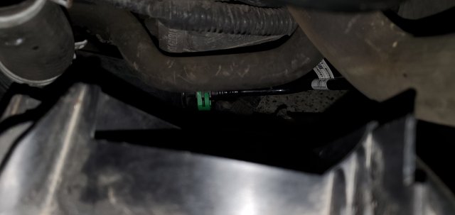

Thanks for the comment!! I did some digging and I THINK I found what you're talking about.
I looked at the cold pipe (that has the monotune part from the above picture) and saw this small connector, but i noticed it's only connected to the pipe....and nothing else. 20250113_161849.jpg
Is this the evap connector you're referring to by any chance? The connector that would go into the picture from my previous post with the cap and then connect to the cold pipe (at the location my finger is pointing at with the small blue piece).
I looked at the cold pipe (that has the monotune part from the above picture) and saw this small connector, but i noticed it's only connected to the pipe....and nothing else. View attachment 65100
https://parts.ford.com/shop/en/us/fuel-chassis/fuel-vapour-separator-tube-14477913-1
Yes indeed.

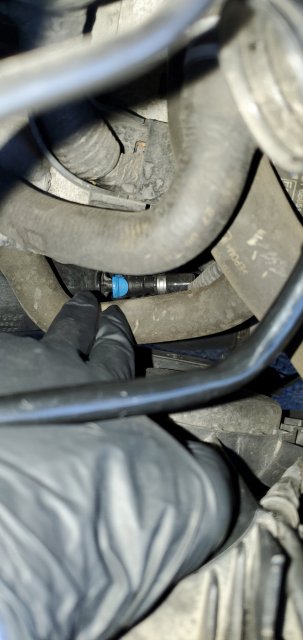

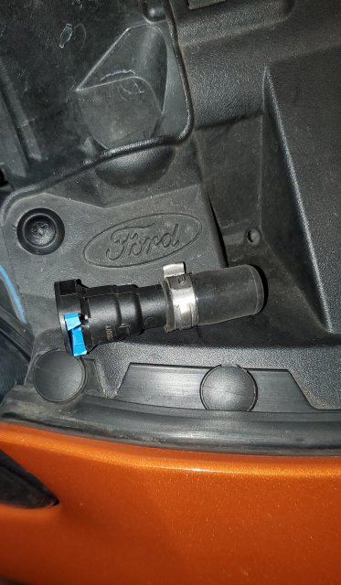

I decided to finally try and see if I can pull out the blue piece myself today. I had to disconnect the other part of the evap line to get some room to put my hand underneath. Couldn't entirely fit my hand but i was able to get a trim piece pry tool to try and open the clip.
That didn't work...I sadly didn't know how to remove the clip holding it in place. But after prying it with enough force, I ended up completely breaking the clip off.
Was ready to throw in the towel and just wait for Monday for the dealership to take the car.
BUT, I then realized the exposed parts after the clip broke made it EASIER for me to remove the whole piece. I was able to squeeze and pull it out!!
This little sucker was the reason for my check engine light!! 20250118_113303.jpg
Pulled it out, and put the new evap line. A little hard to see, but it's the green connector as many of you might immediately recognize.
Went to the autozone near my home, got my code cleared.
Drove more than 70+ miles today including going WOT on the highway
NO MORE CHECK ENGINE LIGHT POPPED UP!!!
I can't thank you guys enough for the help, especially you @akiraproject24 . Finally able to drive and enjoy the fiesta after I first got it 2 months ago.
