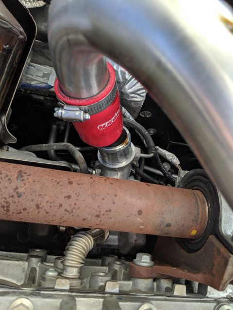

Well apparently your turbo has to be connected to make power. I hadn't heard of anyone having issues with the turbo boost hose popping off so it was the one I left single clamped, guess it was the path of least resistance because of that.
Had to take a double clamp off the J pipe because I have no idea where the original one ended up, probably on the highway somewhere.
Will probably buy some backups and try to double up this weekend on the entire hotside, idk if two clamps will fit next to the turbo outlet though so maybe the hairspray method will be sufficient.
Moral of the story is clamps every once in a while lol. I had just tightened everything last weekend but maybe I overlooked how tight the turbo outlet hose should've been. That or the clamp I put on was bad and didn't hold. Either way I'm happy to be making that sweet 26 PSI yet again.
