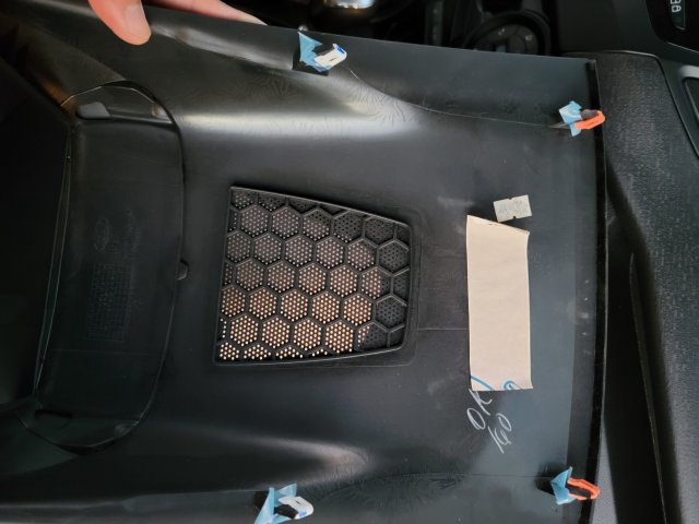

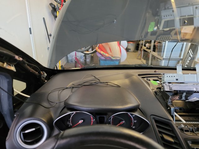

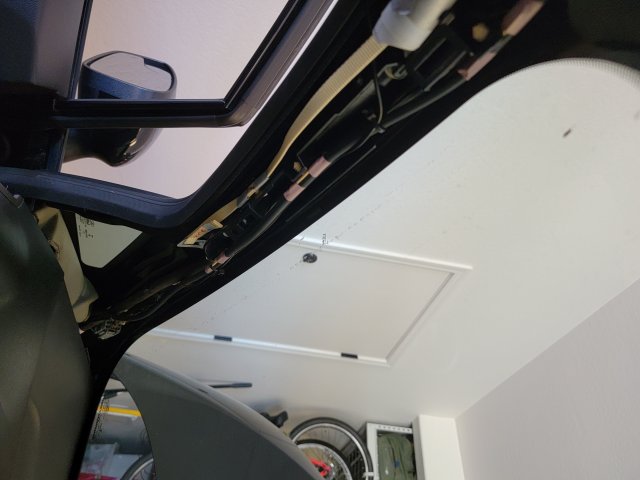

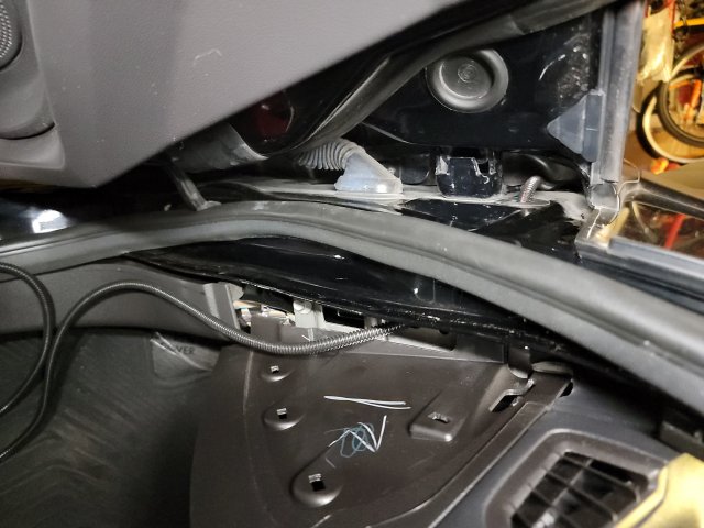

This car came with all the options I wanted (actually, I didn’t want the sunroof but it is what it is) except for the backup camera. I’m handy with Forscan and used to removing the panels so I followed the guide I found here and on YouTube except that I ran the cable on the driver side to avoid needing an extension.
If I had to do it again, I’d go with a hatch release mounted unit rather than the license plate light one for more centered camera, but this isn’t bugging me enough to replace it unless it breaks.
Cable going down the drivers side a-pillar:
Looks like others went the passenger side route since it’s easier to pass the cable through the dash on that side, but it wasn’t hard finding a path through on the driver side using a nylon tubing. See ends of white tubing by the pillar and display areas:
I lost a couple of plastic clips on the display cover when I pulled it. It mounts back on without issues with the remaining clips but the rattle was bugging me, so I bought some replacement clips on Amazon. They look and fit exactly like the stock ones except for the color, but you can’t tell the difference once the trim’s reinstalled anyways:
Camera: Navinio Backup Camera for Car, Waterproof Rear-View License Plate Car Rear Backup Parking Camera for Mondeo/Fiesta/Focus Hatchback/S-Max/Kuga/Everest

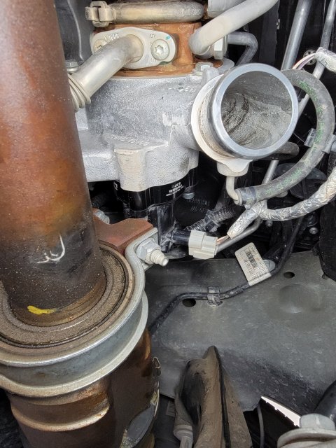

I wouldn't waste money on the aftermarket downpipe. With the stock turbo nothing performs better than the stock downpipe.
I won't do the downpipe swap until I do the turbo upgrade so I don't have to worry about any broken bolts. I felt improvements on other turbo I-4's and V-6s with the downpipe upgrades even with the stock turbo, mainly in turns of turbo lag reduction. Is it not the same with Fiestas?

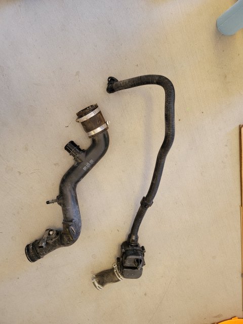

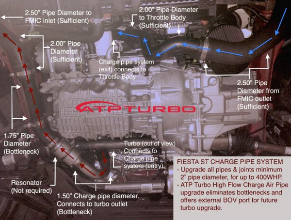

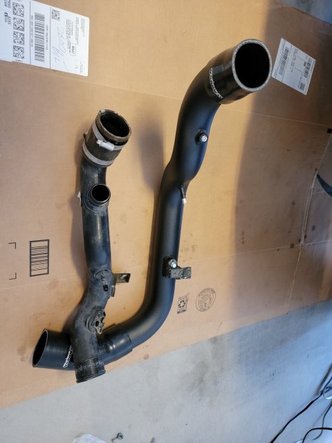

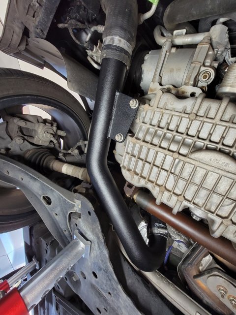

While the cold-side pipe isn't considered as a bottleneck, they are cheap and the Whoosh unit comes with the symposer-deleted and a bung for the WMI nozzle, so I decided to kill three birds with one stone.
Stock pipe vs the upgrade:

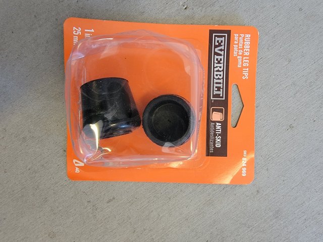

Took the symposer out along with its tubing. Capped the other end with a 1" rubber capping for a chair, which was a leftover from capping the airbox muffler delete on the Mustang.
Cold-side pipe installed with a nozzle:
No, the whole exhaust cannot be improved upon for power with the stock turbo. Sound can be made louder but that's it. Once you change the turbo to a bigger one then you can see gains with different exhaust. Ford Performance did a good job with the design of the stock exhaust.

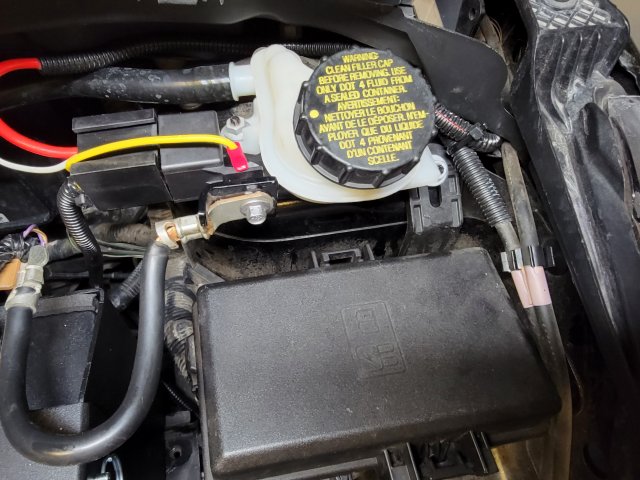

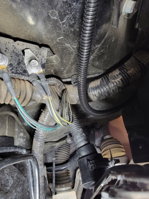

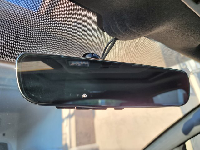

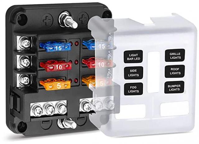

The Mustang has a Homelink garage door opener (located on the sun visor) and auto-dimming rearview mirror that I like, so I installed a Gentex auto-dimming rearview mirror with Homelink (model ADVGENFLCHLN). My wife says it looks like it came from the factory as an option, and even has a display that shows the direction of the garage door travel and works a little farther than the ones in the Mustang and my wife's car.
I also installed a hardwired dashcam at the same time, and since I knew that I will be adding more accessories later, I also installed a dedicated fuse box for them like I did with the Mustang.
I found an unused fuse slot that provided switched 12V power using a multi-meter and installed an "add-a-fuse" on it. I used it to trigger a relay that connects the 10 AWG wire to the battery going to the fuse box mounted in the cabin. The fuse box also has a centralized point for the ground wires so I ran the ground wire to a nearby ground point.
Engine bay fuse box:
A relay mounted near the battery:
Ran the wire by the driver side fender, similar to how some folks ran the wire for their amp:
The original plan was to mount it near the driver side kick panel as I did with the Mustang, but that there's a lot less space there (or anywhere else under the dash area) for the Fiesta. Ended up finding a perfect spot behind a panel by the shifter on the passenger side. I can't find the picture of the fuse box install now but below is the one that I installed. It currently has rearview mirror, dash cam, WMI controller, and boost gauge wires on it, leaving room for two more devices:
Fuse box: PSEQT Newest Mini 6-Way Blade Fuse Block Box with Negative Bus ATC/ATO & Warning Indicator Waterproof Marine Automotive Standard Circuit Holder Panel for Boat Yacht Auto RV Car Trailer Truck

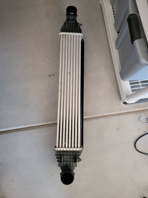

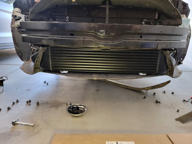

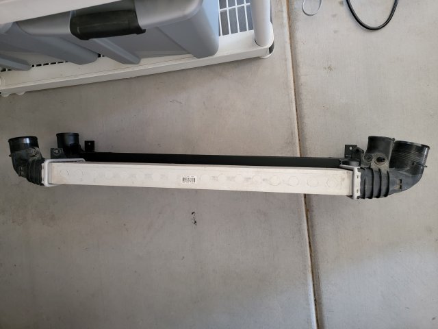

I went with Whoosh v1 as it claimed to be good up to 300 whp, which is good enough for my use case. Below is height and thickness comparison with the stock unit.
I was hoping that no trimming will be required with it being one of the smaller aftermarket ICs but unlike the Mustang, there wasn't any room to spare. I was able to shove everything in to remount the bumper cover without trimming but I didn't like how it bulged out, so I ended to taking the cover off again and trimming.

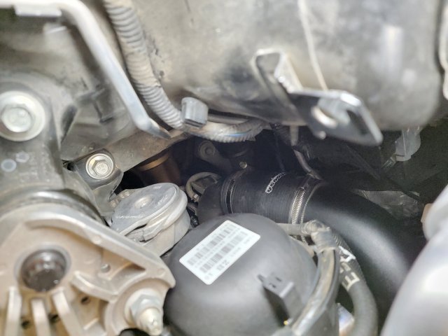

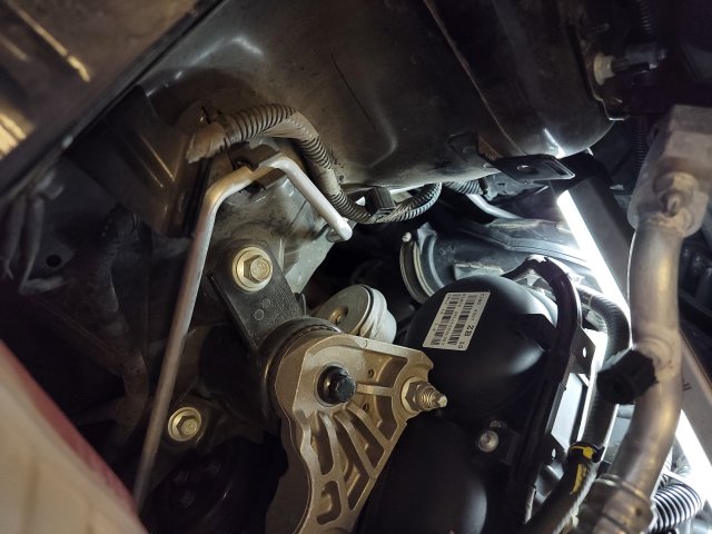

I was originally going to wait until the turbo upgrade to upgrade the crossover pipe, but I found a used one at a good price.
When I took the coolant reservoir off earlier for the passenger side MM bolt upgrade, I noticed that removing it also provided an easy access to the crossover pipe clamp. So rather can taking the cowl off, I just unscrewed the clamp (which was loose BTW), wiggled the pipe off, and snaked it through the other side.
After the swap:

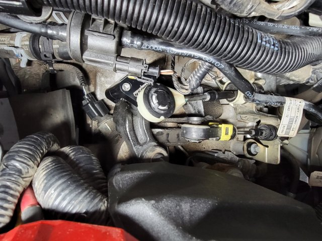

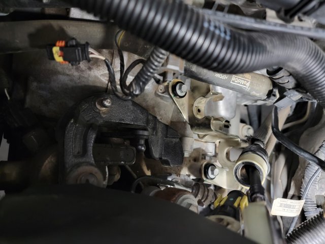

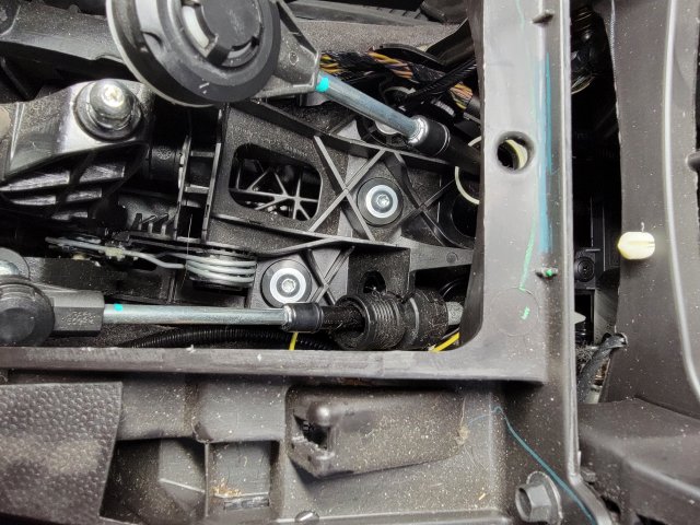

I thought the stock Fiesta shifter was pretty decent as is other than a little long throw. I installed the Whoosh short shifter along with the base and bracket bushings and the difference was incredible for such a simple mod. The shifter feels noticeably tighter now with short and crisp shifts.
I was able to do the base bushing swap without having to take the console off. Taking the shifter cables off provided ample wiggle room to slide in the new bushings.

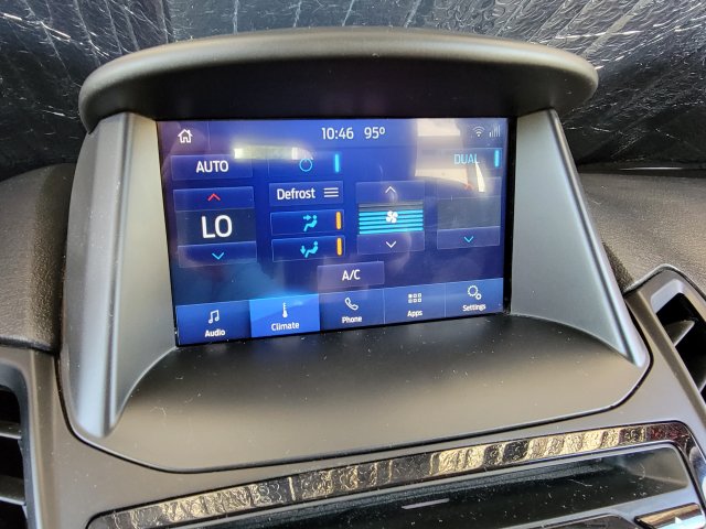

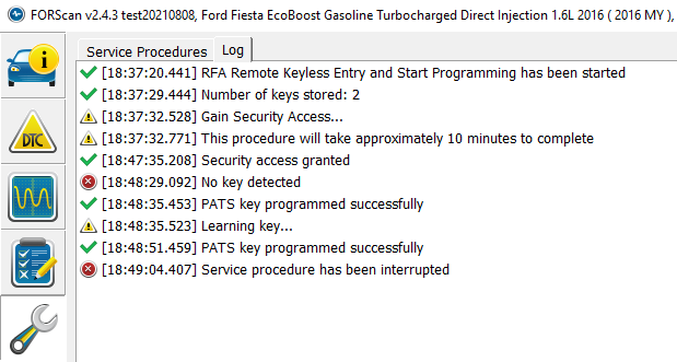

The car came with only one fob and since I know Forscan can be used to program fobs even if you only have one in your possession, I decided to roll the dice and try an aftermarket fob for $25.
Programming via Forscan worked and it now shows three keys stored (it can store up to four keys). Now I just have to find someone that can copy the metal key portion. Tried Home Depot and they can't copy car keys.
While messing with Forscan, I went ahead and updated a value to enable the Climate display:

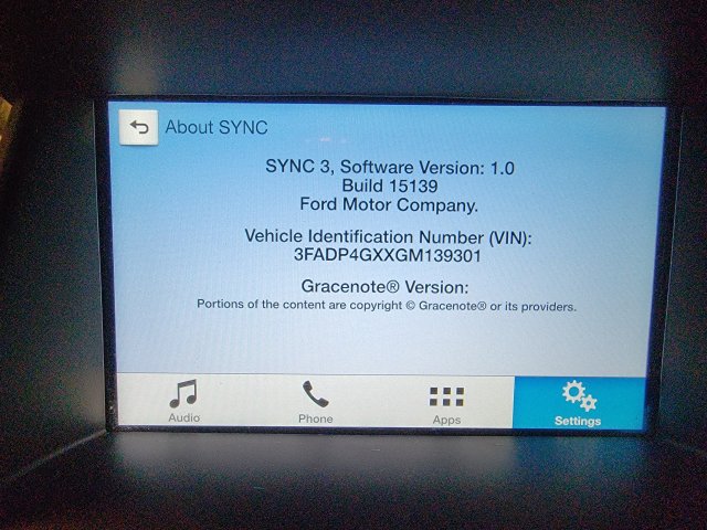

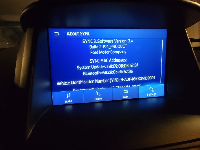

The car came with SYNC 3 software version 1.0. It didn't support Android Play so I tried upgrading to version 3.0 via the official method by downloading the software from the Ford site. Theupgrade didn't after repeated tries, so I just went with an unoffical 3.4 upgrade via CyanLabs and it upgraded on the first try.

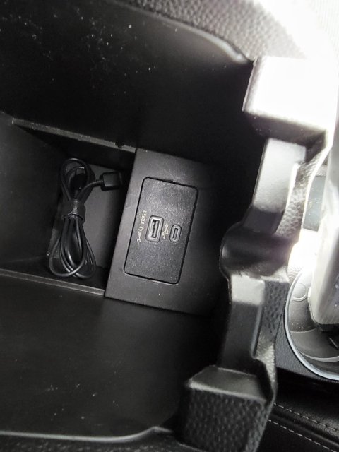

After the upgrade, I was getting an annoying "USB hub incompatible" warnings during the starts. While the hub worked without issues, turns out that offically, version 3.4 isn't compatible with the old hub. I went ahead with the hub upgrade to get a USB-C port in addition to getting rid of the annoying warning messages:
USB hub: Dual USB Interface Module Replacement USB & Type-C fits for Ford Lincoln Apple Carplay Supports SYNC 3.3 3.4 Version HC3Z-19A387-B HC3T-14F014-A SYNC 3 USB Media Hub USB Interface Hub

Do you have more info specifically in how you did this? What guide did you follow?
I pretty much did what CarGuy mentioned above. The hardest part was holding the new fob just right on the steering column.
