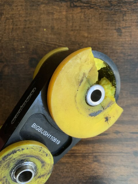

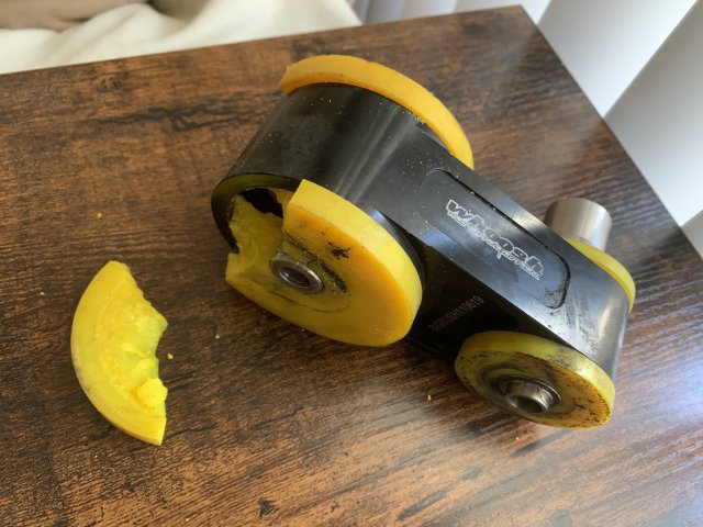

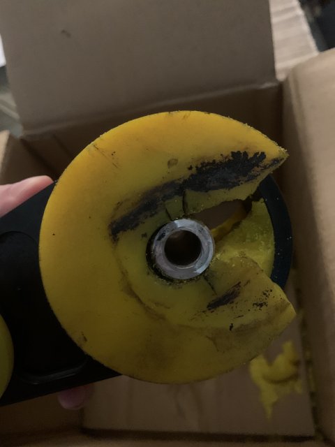

So a few days ago about I was experiencing a lot of nvh and a massive clunk from low rpms when accelerating in any gear. I just got it back from the dealership (car is still under warranty) and they told me my aftermarket (Whoosh street rmm) was the culprit. I was extremely surprised to say the least. I've bought whoosh motorsports parts in the past and I have always been satisfied until now. The car was purchased new and has just hit 8k miles with only 5k miles on the whoosh rmm. It was torqued to spec and re-checked 2 months ago. Never tracked or really pushed the car super hard either. However, as you can see from the photos…the rmm is toast. Got stuck paying the dealership labor cost to reinstall the factory motor mount. As you could guess, the car feels so much better now even with the stock mount. Just wanted to update anyone who saw my previous post and for any owners/future buyers who have or want a rmm to be aware of this potential issue. I'm not sure if anyone else has had an issue with Whoosh's street rmm but I would be weary. I definitely expect this part to last way longer than it did, especially with how many miles are on the car. Like I said before, I've bought products from Ron before and it's been great, but this one has not. Here’s the video of the sound it made while the rmm was installed https://streamable.com/06uvmm and photos of the rmm taken off the car.
