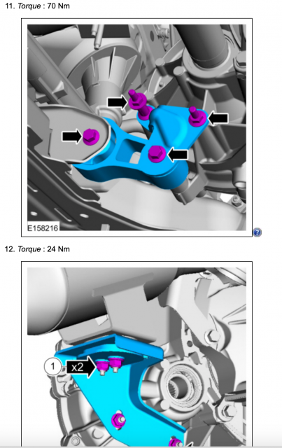

According to the manual the bolts holding in the RMM itself should be torqued down to 50 Nm and the nuts holding the bracket only need to be torqued to 24 Nm.
312
125
Brooklyn
I thought I saw 70Nm, for the bolts, in the manual.
DEss
190
134
Michigan
DEss
You may be right, I think I only found instructions that show the torque for the rmm bolt on the subframe side.
Sent from my SM-N975U using Tapatalk

You should be fine while u wait for replacement bolts, might have a bit of rattle from the exhaust but it shouldn't be too big of an issue

The instructions that come with the CP-E RMM clearly state to use 52 LB. FT. right in the text. [wink]
I don't know if that differs from the Ford manual or not. [dunno]
Now that you mention it my Vibratechnics RMM stated 67nm which translates to 50 Ft. Lbs.[rockon]

Since everyone is chiming in, I will too. All the rear motor mount bolts are 51.6294 Ft-Lbs. The downpipe bracket NUTS are 17.70 Ft-Lbs.
