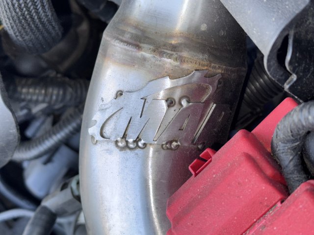

Figure out what kind of intake you have and post a photo - there are known issues with some intakes, especially on 2016+ cars, causing issues with the evaporation system that contributes to stuttering and hesitation, and sometimes outright stalling, after filling up.
Also post whatever other modifications you have - who did your tune, how is it tuned, etc.
Here are some that I just took. As far as the tune, there was a set of stage 1, 2, and 3 with 87, 89, 93 available on the cobb. When I got it, it was set to 3 on 93. A quick google suggested that wasnt good for longevity if I only had an upgraded intake, so my bf suggested changing it to stage 1 on 93. Idk anything about tunes or the previous owner’s plans, so I’m unsure if that was preprogrammed or done somewhere and imported.

What you need to do is get a scan tool that can run and Emissions test that will clear or fail the system. Id be curious to see how they have the Emissions harness with the Purge valve setup underneath the intake you have in this picture. Another thing you could do is clean the Capless fuel system also.

Based on the available info you've provided, if it were me (and I'm retarded) I'd do this
I'd replace the purge valve assembly (octopus looking thing connects to cold side pipe and intake etc). I'd probably also do the vent canister solenoid (small solenoid that lives down by the fuel tank/charcoal cannister) and I'd want to look at the downpipe to see if it is catted or catless or aftermarket in general.
Secondarily I'd probably replace that intake with oem or ST200 if and when I could find someone parting with it for a good deal.
I'm no trained mechanic however, I just enjoy wrenching on my cars
Could also check for torn or disconnected vacuum hoses or their connectors not fully seated

View attachment 64321 View attachment 64322 When I got it, it was set to 3 on 93. A quick google suggested that wasnt good for longevity if I only had an upgraded intake, so my bf suggested changing it to stage 1 on 93.
This is likely your problem. It sounds like you don't know that all you have is an upgraded intake - "Stage 3" is for an upgraded intake, intercooler, and catless turboback exhaust. Running a stage 1 tune with all of these mods can cause the issues you are describing.

and also its common the o rings on the evap harness connection tear especially while removing I would check for that first as its the cheapest option
Hmm good point, it didnt look like those mods were done, hence it was changed to stage 1, but I’ll look into it
