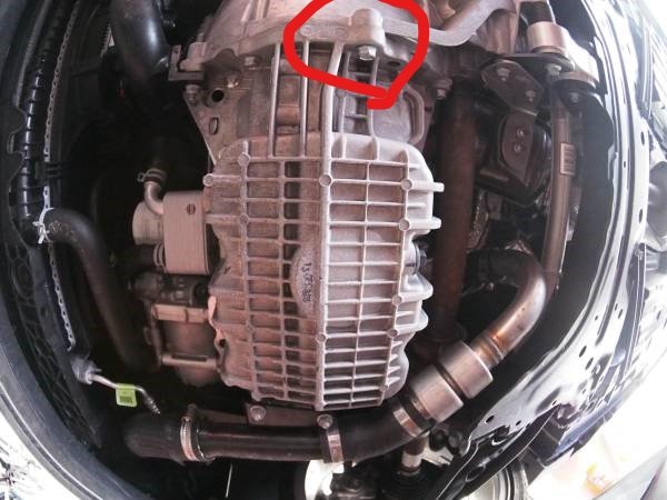

So I noticed 2014 FiST was running low on brake fluid last month, I decided to just top it off. Last week I went under the car and noticed some fluid dripping from the lowest point on the transaxle (near that lowest bolt in the picture, not my car though). Also, the brake fluid is low again plus there was a little puddle where I park in my garage. The fluid is clear and oily. But brakes are fine and the clutch is behaving normally nothing completely out of the ordinary.
So I think it is brake fluid correct me if I'm wrong, but regardless Im not sure where to start, where should I check first. Are there any brake lines or anything around there?
Please let me know if anyone experienced this or if you have any idea what my next step should be.

Is this Fiesta AWD? I don't see a Transfercase anywhere in the picture. I see a Manual Transaxle for A FWD FiST.

Check the Clutch pedal inside the vehicle for leakage as others have found. Does the pedal have any issues? Getting stuck down? Won't return after being depressed?

My 2019 clutch slave cylinder leaked 2 months ago. W/o raising on a lift, my fluid was only visible where the Trans meets the engine, on the underneath side. That exact same spot... Nothing from the top, front or rear. Mine went from working to zero <an hour.
You need a mirror or USB C snake light to look where the slave cylinder connects to the housing/case also. Best of luck...either a long repair at home or $$$ in a shop. The seal at the housing was bad too, so they replaced the slave cylinder, complete supply hose and clutch disc, under warranty.

This also gives the opportunity to do an LSD if your into Modding or been wanting to do one. You will need a Boroscope / Endoscope. You can buy them off Amazon that will work with your Phone and have a light and HD function if you wanna get technical. Good luck and keep us up to date! How many miles also on the FiST?
Darn right right, transaxle is what I meant I will edit that.
